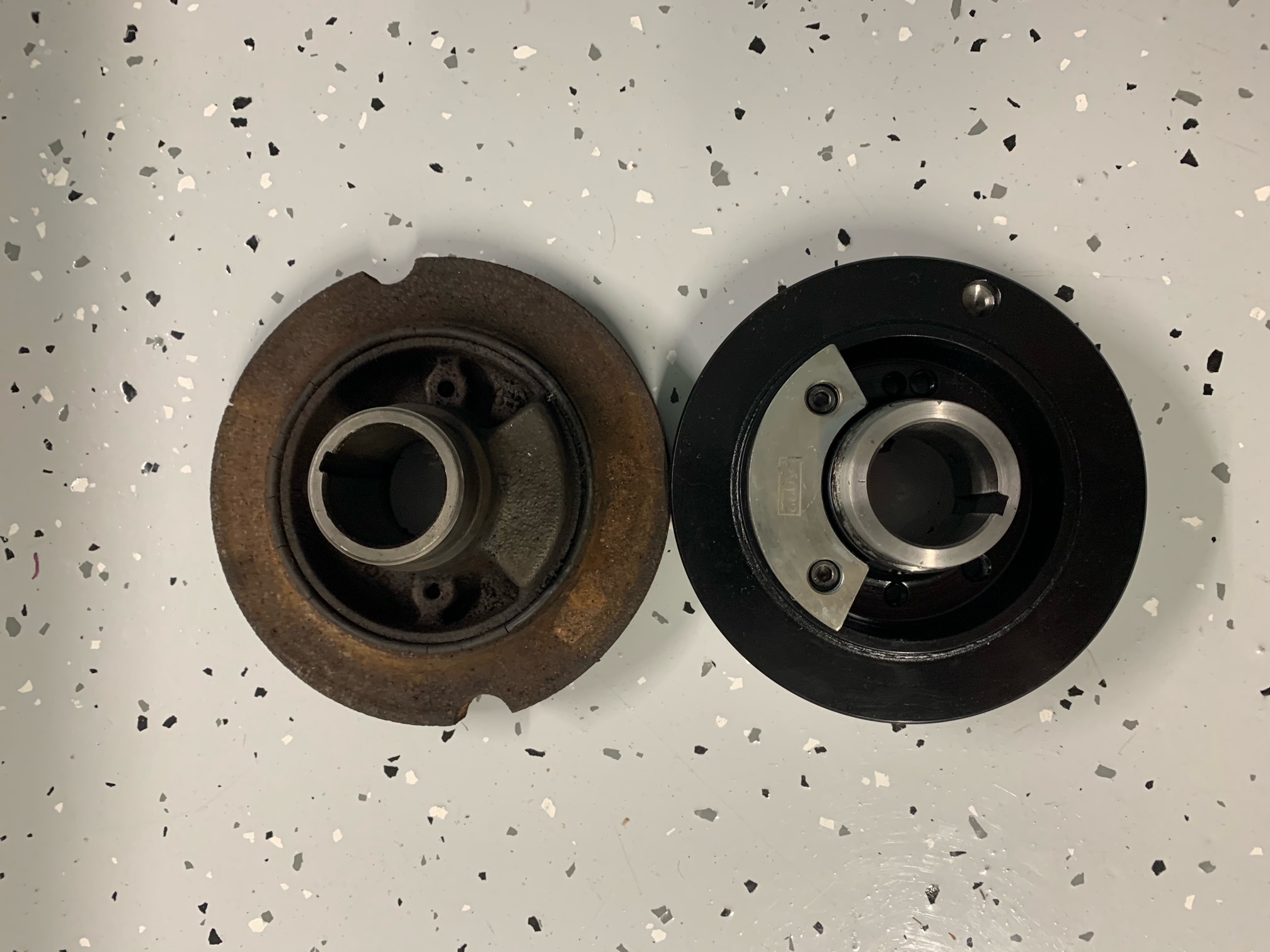

I have purchased a Professional Products PowerForce Harmonic Dampers 80022 to replace my failing harmonic balancer on my 1967 Toronado. The old one has spun the outer ring (rendering the timing mark useless) and the rubber is cracked and rather wavy. The new harmonic balancer is linked below.
https://www.summitracing.com/parts/pfs- ... +Ad+Groups
The counterweight that comes with this new harmonic balancer (measured as ~516 g) is larger than the counterweight that was cast into the original harmonic balancer. See the two balancers in the picture below.
Does anyone have any experience or issues running this larger weight on their 425? Does anyone have a target weight for the counterweight in this application? Have you cut the weight down?

There was only 1 weight provided, 516 g. So, I considered that this new counterbalance weight is designed to fit my 69 Olds Cutlass 350. I measured all three harmonic balancer dimensions, the 1969 350, 1967 425, and the new balancer.
I took the ratio of the counterweight volumes of the 1969 350 harmonic balancer and the 1967 425 harmonic balancer. That ratio was 130:78, by volume, there is no practical way to measure the weights weights. I am taking a leap of faith that the PRO Products weight is accurately sized to match the 1969 350, as it has nearly the same dimensions and the PRO Product technician indicated the proper application of the part. I estimated that the Toronado weight is 325 g, however, it is at a longer effective moment arm than that of the PRO Products weight.
So I split the baby, cut off 0.2 in (~100 g), and hope that it is close enough. If not, I will remove another 50 g. After that 25 g. I have read that +/-28 g counterweight accuracy is the minimum required. At some point, with enough dull hacksaw blades, I’ll hit it right. Or I won’t notice a vibration and I will drive down the road fat, dumb, and happy.

I assume that shiny divot in the new balancer was drilled out by you. Do you just drill a little and weigh the piece, drill a little more and weigh it again, etc. until you remove the amount you want?
How do you decide where to take the metal out?
Sorry for all the questions. I've never done anything like that before.

Otto Skorzeny wrote:I assume that shiny divot in the new balancer was drilled out by you. Do you just drill a little and weigh the piece, drill a little more and weigh it again, etc. until you remove the amount you want?
The shiny divot was in place on the new harmonic balancer when I received it. I made no modifications to that. I took the approach to adjust the weight only. If you look at the other PRO Products harmonic balance applications, the weight is the only change between the various engines and years (e.g. Ford 351 Windsor vs. Ford 351 Cleveland.). So I followed the same approach, just change the weight.
Since the weight is almost perfectly symmetrical and in the correct radial location, it was simplest to remove the top surface for more predictable results. Although it is painful, I would rather remove smaller than estimated mass each time so I don’t overshoot and have to buy a new weight.
