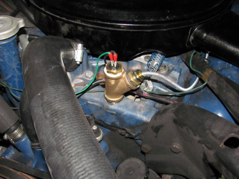

I bought an inexpensive engine temp gauge and my mechanic installed it. See lower photo. It works wonderfully.
I did not want to lose the function of the dashboard engine temperature warning lights. My mechanic recommended and I agreed to a small engine modification. See upper photo. If anyone desires an explanation, please post a reply.
- Note the accelerator cable's spring-within-a-spring arrangement, for redundancy.
