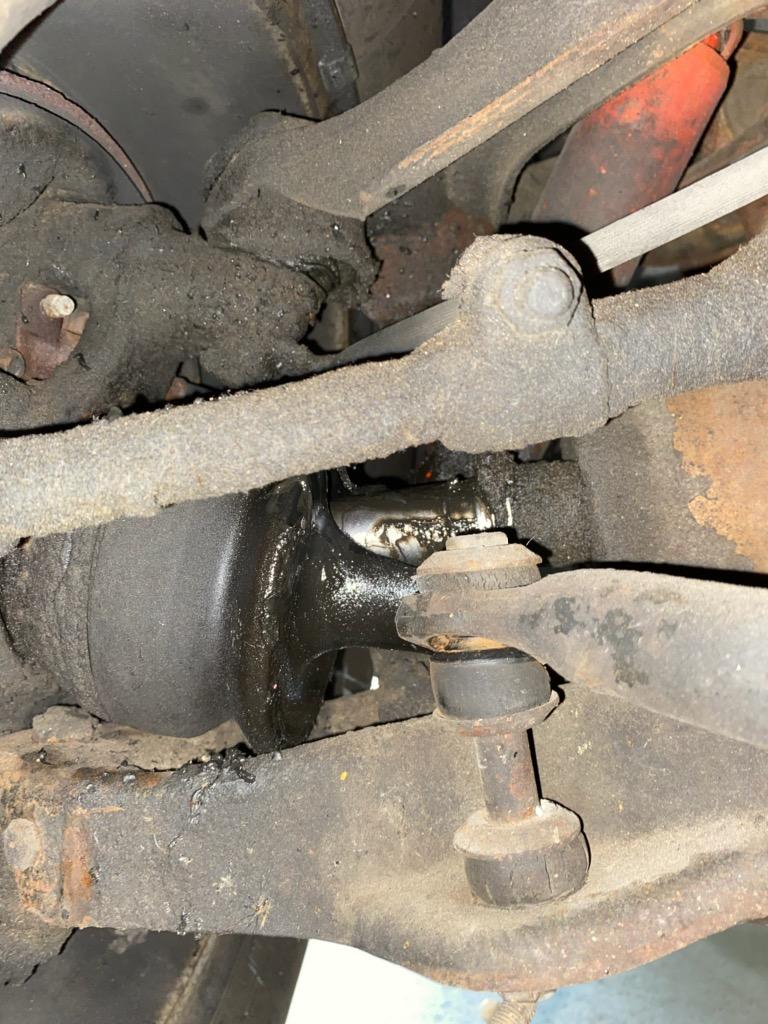

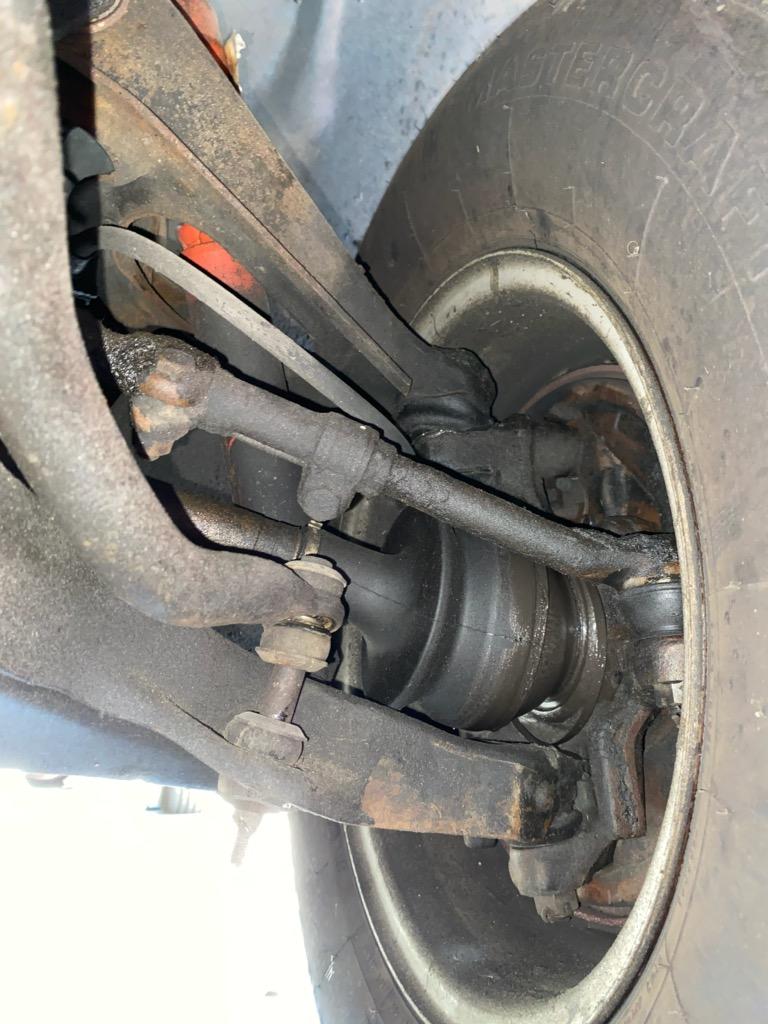

Hi Everyone. I always appreciate the great advice I have received here-many thanks in advance. My son was under the vehicle recently for the first time in a long time, and he noticed that we have a missing CV joint boot on the passenger side. I am attaching pictures of the driver's side (booted) and the passenger side, where an exposed rod can be seen. I haven't laid under it myself to get a look, but I'm kind of confused by what looks like two rods. I am sure that it is in fact the CV joint with no boot.
Does anyone have experience knowing if boot kits are available, and is the process fairly simple? Any links or resources anyone could provide would be much appreciated.

I had difficulty understanding the second photo until I realized that the cv boot is still there, just not covering the axle. There is only one shaft, not two, and yours is exposed. The boot has come off the small end and torn down the side while remaining partially attached to the wheel end.
I would buy a Speedi Boot kit if you don't feel like taking the entire wheel assembly off the cv axle. It basically zips up the side with glue and little screws, and clamps at both ends. I replaced the same boot on my car a few years ago.
I used a hose clamp on the big end because I couldn't get the crimped factory style clamp to close properly.
Speedi Boot part# 03609 for the outside joint. I got it at Auto Zone.
My car is a '66 but I think its the same diameter as yours.

Otto Skorzeny wrote:I had difficulty understanding the second photo until I realized that the cv boot is still there, just not covering the axle. There is only one shaft, not two, and yours is exposed. The boot has come off the small end and torn down the side while remaining partially attached to the wheel end.
@Otto--you are invaluable! I will get a look at the car soon then pursue your advice, and report back with findings. Many thanks!!
