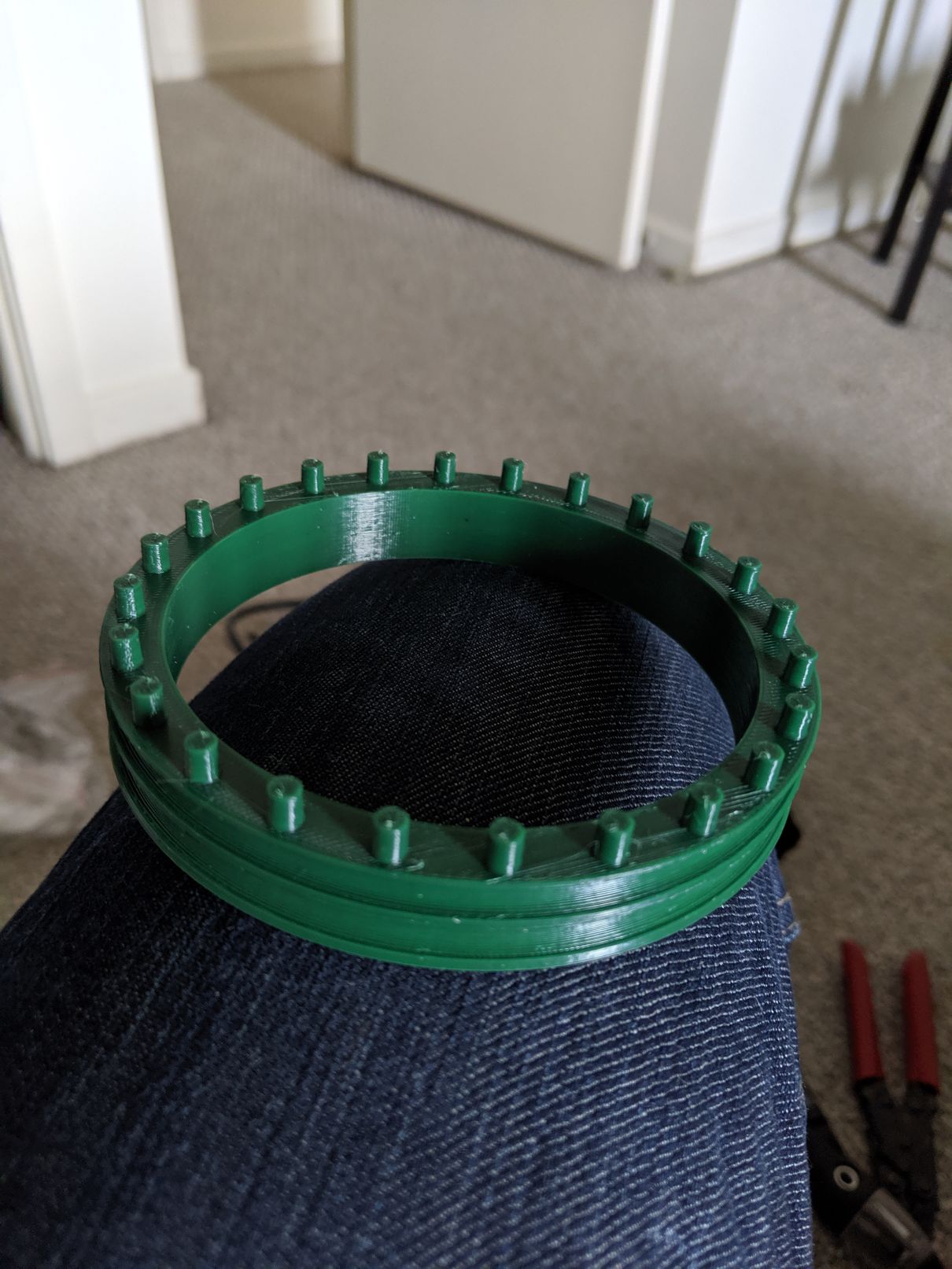

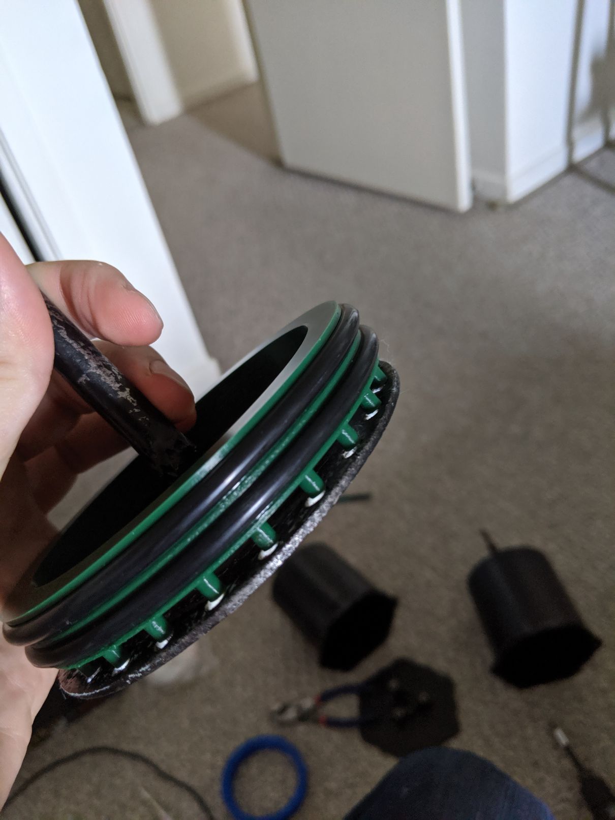

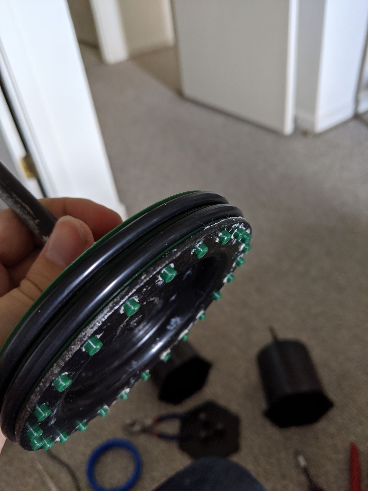

Here is a solution you can try :

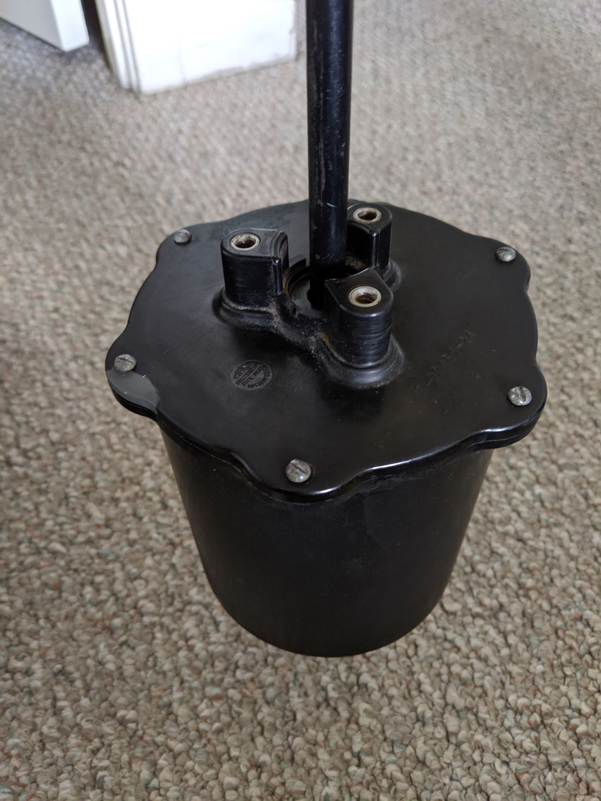

- Open the canister that doesn't work by removing the six screws on the top, be careful as the spring inside is very strong and might damage the cover if you don't hold it strongly while removing the 2 last screws.
- Remove the axle if it didn't jumped away and the spring
- Cut the old rubber and remove it completely
- Remove all the rust and clean the part, you can even paint it if you want
- Use the file provided to print the part that will hold the o-rings in place
- Use glue or any adhesive that holds to plastic and can cover enough so air won't pass between the two pieces
- Let it dry completely and add the two o-rings on it
- Put everything back together and test if the canister holds vacuum
- It may let some air pass through it but not much
- Try on the car !

Toronado 66 headlight actuators
- IMG_20191005_195053.jpg (161.67 KiB) Viewed 25800 times
- IMG_20191005_151957.jpg (172.95 KiB) Viewed 25800 times
- IMG_20191005_151936.jpg (181.26 KiB) Viewed 25800 times
Re: Toronado 66 headlight actuators
More pictures
- IMG_20191005_143449.jpg (247.1 KiB) Viewed 25799 times
- IMG_20191005_151842.jpg (250.08 KiB) Viewed 25799 times

Yes, the green part is made of platic. There was no old plastic part, before it was just a big piece of rubber. I have a 3d printer at home that I use to make platic parts. It is ABS in my case, I find it more resistant.
On the website, there is a button "Download all files" and you should have a .stl file. This is the 3D model that is used to print the part.
