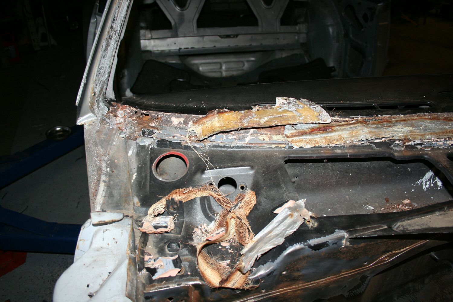

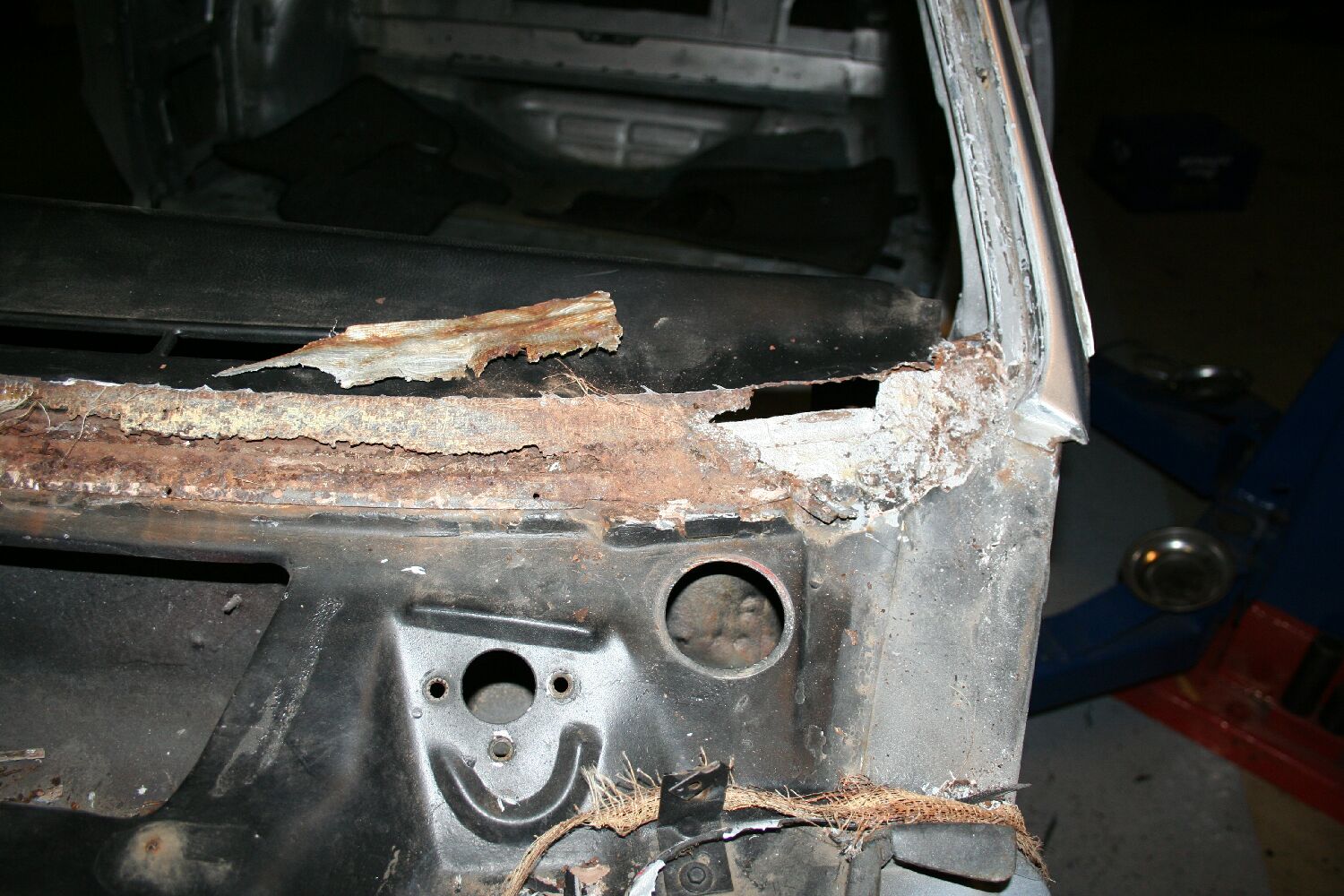

Hi guys ,
first of all . . . my topics/account ?. . . were deleted due inactivity thru the last year.
I was registered in 2015 when I bought my 66 toronado.
what do you use as windshield channel ?
mine isnt existing . . . just a kind of bondo/silicon stuff.
does anyone has a reference or source of rubber that you use ?
Or maybe anyone can give me the measurement or cross section of the channel ?
thanks guys . . .

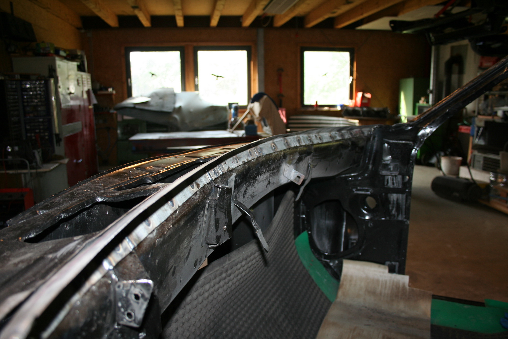

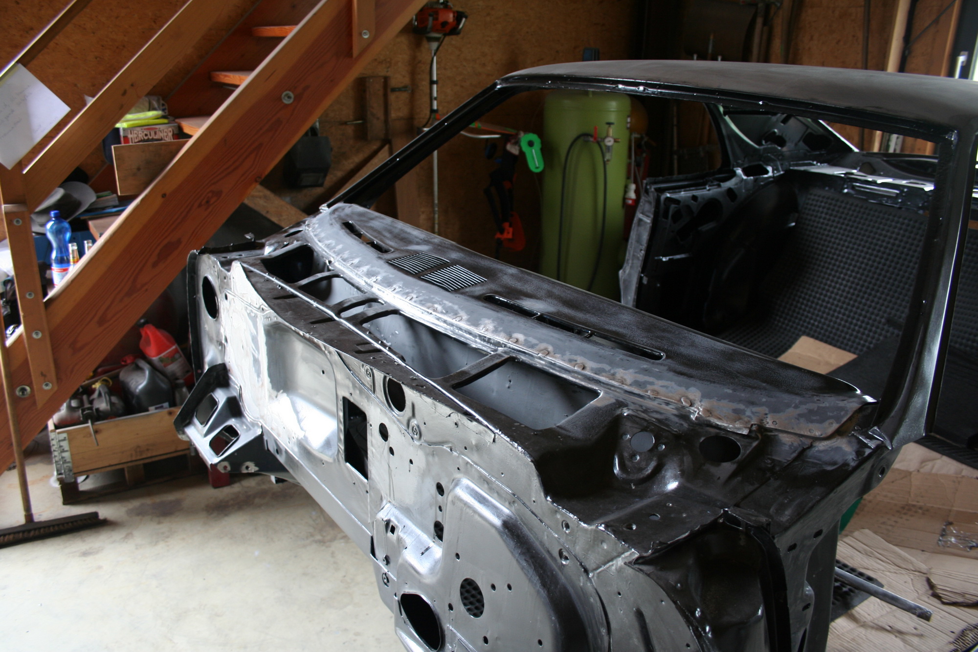

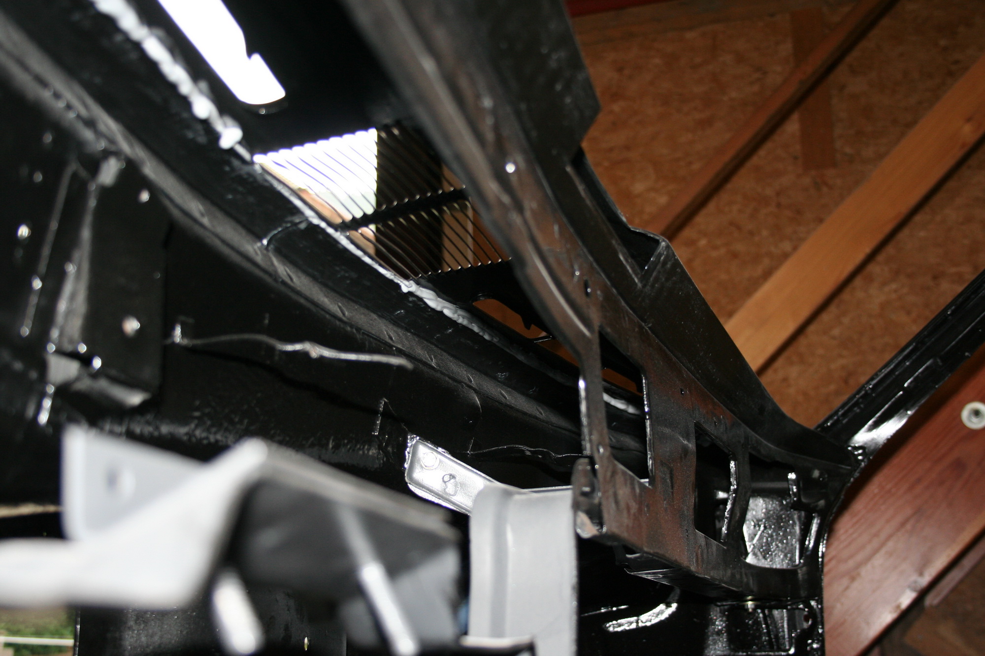

Ok Gents...here I am... please excuse me the 1956 Caddy eats up all my time..;-)
harascho
Posts: 106
Re: windshield channel 1966 Toronado
Postby harascho » Thu May 10, 2018 9:39 am
and the solution:
harascho
Posts: 106
Postby harascho » Thu May 10, 2018 9:40 am
and more..

Great job on the repair, I have this to look forward to on my 66. Maybe not to that same extent but I seem rust holes in my corners.
