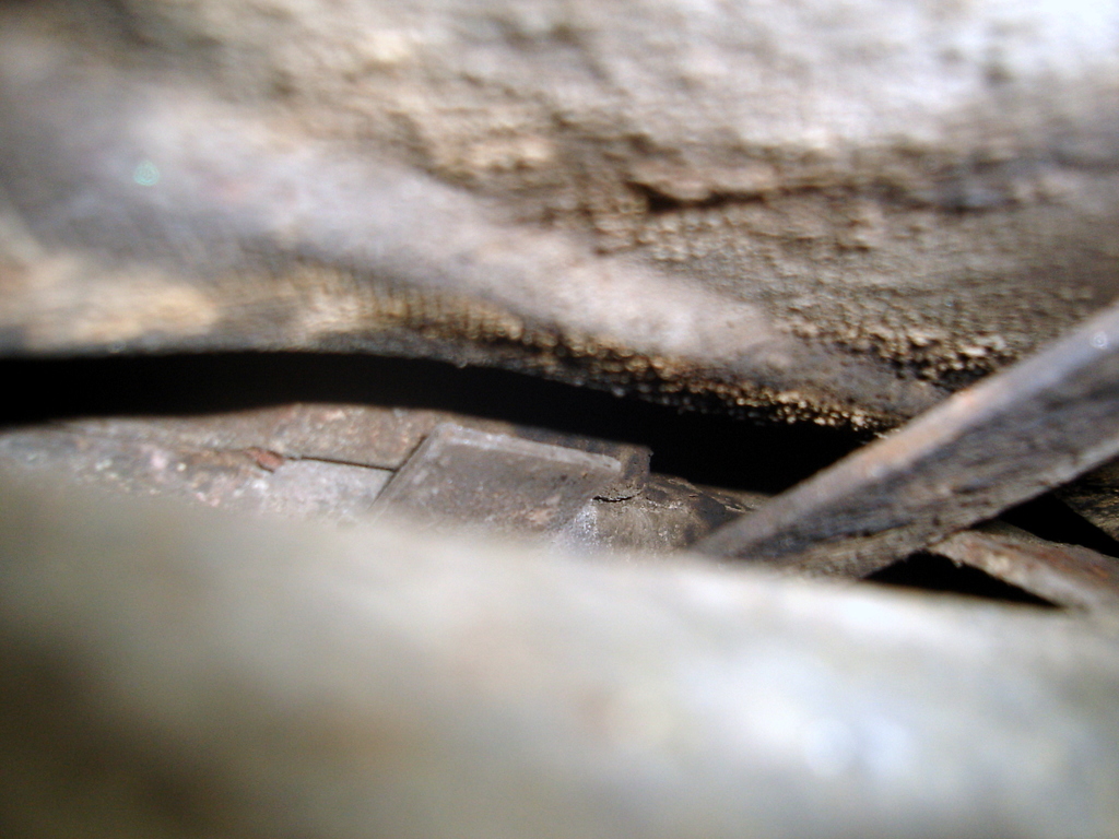

Can one of you post the back-end underbelly of your car? I need to figure out how to lower the two straps that hold the tank up but I can't find any photos or help online in doing so. The two straps are held up by some bolts or large pins of some kind but mine are covered in baked-on road grime or fire-retardant. Thanks.

OK Mergetroid, here it is:
For reference, all photos are lying on your back with your nose scraping the bottom of the tank and looking toward the rear of the car.
The first three pics show the straps hooked into their slots on the rear of the car. This is at the rear of the gas tank.
