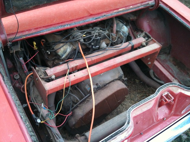

Just bought a 65 Corvair with a nicely installed Toronado 455 and Trans in the back. Looks to be late 60s. What are the individual weights of the engine and trans? (appear stock)
Needs some work but I finally own an Oldsmobile!! (kinda)

The engine weighs somewhere between 600 and 700 lbs depending upon configuration and the trans around 250 lbs and about 75 lbs for the final drive. These are all approximations, but are close enough for general use.

It is a 65 Corsa Turbo that was converted in the 1980s with a kit from Mid-Enginering. Rust free and done properly (in Alberta Canada too). Been looking for a couple years and this one fell into my lap for $3900. Pretty heavy in the rear but ready for Insanity Speed.
Found out the engine and trans were out of a 1966 low mile rollover from the late 60s. Dang thing runs perfectly even though it was stored in a shed for 25 years.

Oh, and forgot to mention it is a 425 if it came from a 1966... and you most likely have a switch pitch trans too. Nice!

Found an almost new Petronics Flamethrower HEI for an Olds last year at Pick and Pull for $15. I had it on the shelf and now I can use it. The year of the drivetrain has been passed for owner to owner for 25 years so I will check the numbers when I Trailer it home this weekend.

Unfortunately, the Mid-Engineering Kit has not been available since the 80s. There are a few built cars out there but they are hard to find. Super heavy in the back but you get to keep the back seat and the powertrain is totally hidden.
The more common conversion is the Crown (Corv8) conversion that uses a reversed corvair transaxle essentially putting the engine in the back seat. The balance of the car is almost 50/50 and can handle like its on rails. The Corvair differential is the weak part and you are generally limited to 300hp. The parts are also not produced any more but there were lots of cars built since the late 60s. They are more common and a few sell every year. I was going after one of those before the Coronado fell in my lap.
