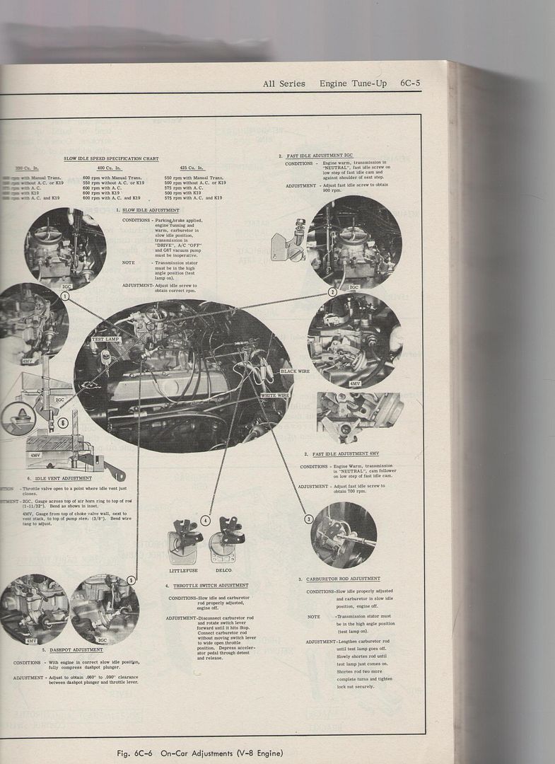

Thanks to Jimsss's suggestion, I found the second hole underneath the throttle cable connection instead of above it. The rod now fits and actuates it for the most part. But it doesn't quite hit both stop in its sweeps. I imagine I have to find somewhere between.
This is the only mention of it in the service manual. It seems pretty straightforward, though the instructions are a little vague as to which of the wires connect to which terminal. Shouldn't be too hard to figure out though. The bottom right shows adjusting for the switch-pitch, and just to the left of it seems to be for the downshift.
