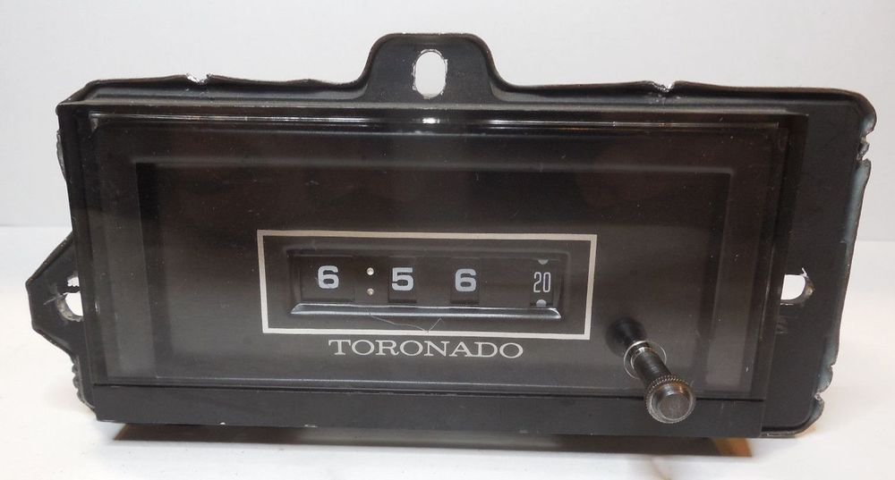

Since the one in my 77 Toronado broke I am looking for a new one.
It it doesn’t have the „Toronado“ lettering it’s not a Problem. I still got the old one and can replace the cover I guess.

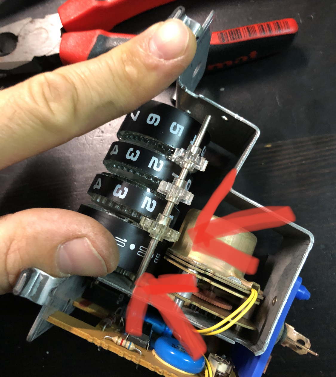

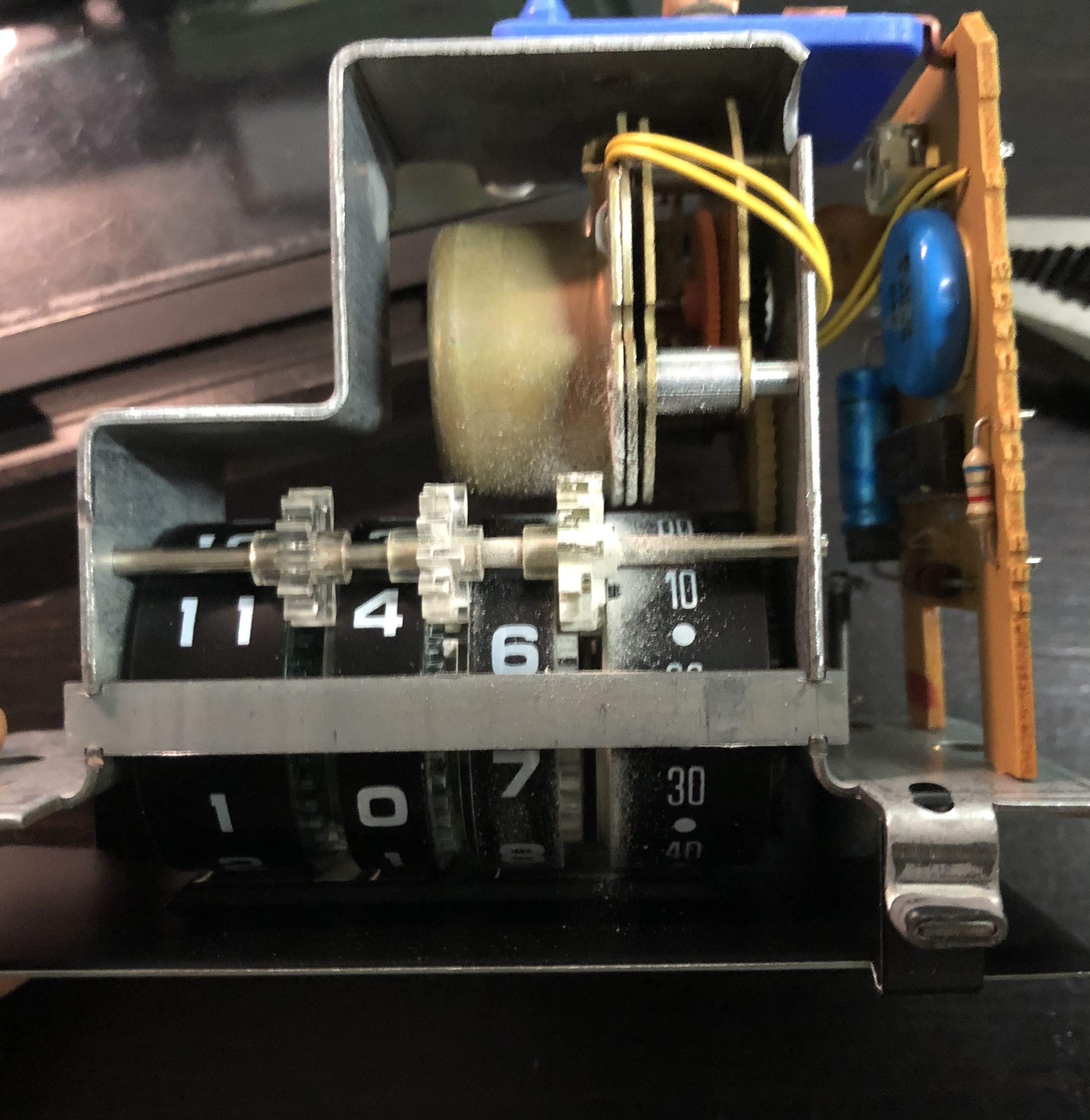

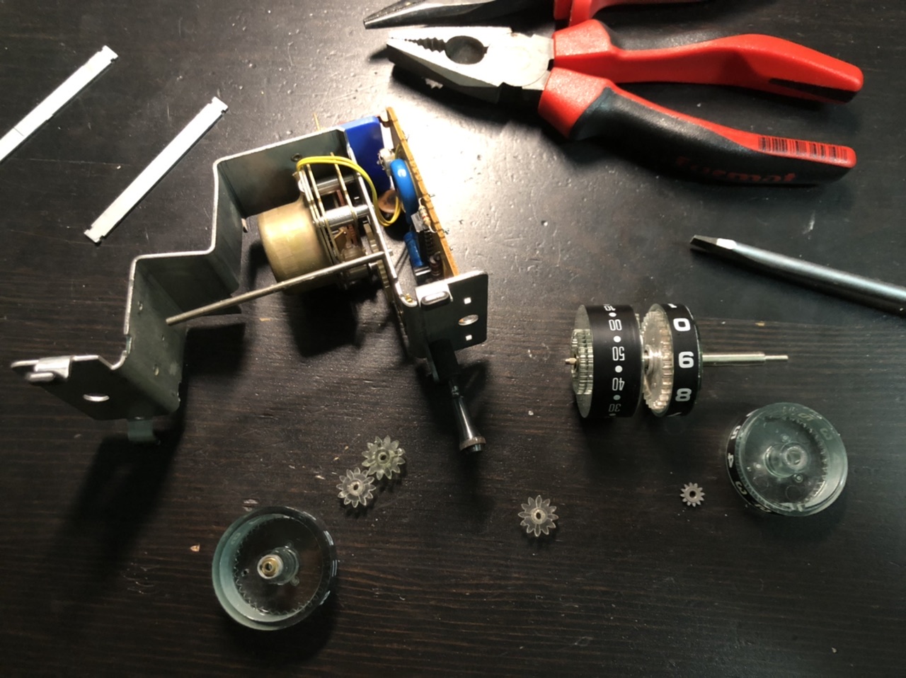

I already took it apart and found a defective gearwheel and pins broken out of the „seconds wheel“
The Problem was that it got jammed coursed by dirt and the motor kept turning, grinding and breaking the plastic stuff.
Unfortunately it can’t be fixed.
The white dust is from the gearwheel grinding into the digit wheel
Defective parts
