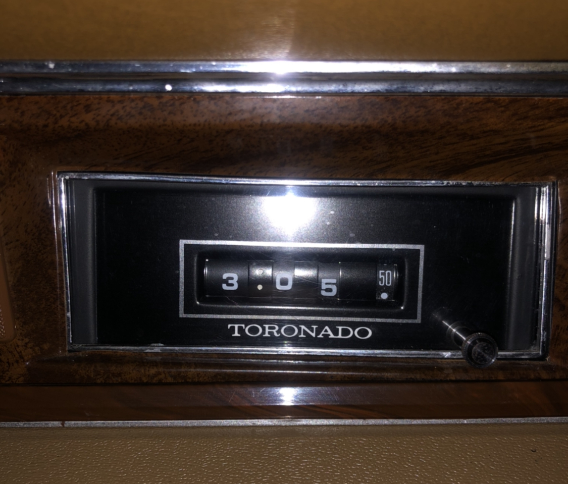

Something to start of with is the digital clock.
I can hear a clicking noise but the wheels with the digits on it won’t move. The little stick on the right (for setting the clock?) doesn’t work neither. Maybe it’s just stuck and needs some cleaning!? Or any other ideas? Is there a way to take out just the clock (through glovebox maybe) without taking the whole dashboard out?

That's cool. Basically a Cadillac Eldorado in disguise.
I've found that most car clocks will start working once they're cleaned. The oil and grease used to lubricate the gears holds dust and lint and it clogs up everything. Clean the electrical contacts, too.
Take it apart and clean it with Q tips and electrical contact cleaner.

Thanks Otto, I will try to give it a proper cleaning then.
The problem is just that I don’t know how to take it out. You can’t get to it through the glovebox but I don’t find a way to separate it from the front panel of the dashboard.

Postby Otto Skorzeny » Wed Nov 18, 2020 6:04 am
If it's like most cars, it will have nuts or screws on the back side holding it to the framework of the dash.

Postby Walle » Wed Nov 18, 2020 6:16 am
Ok then I will try to find the easiest way to get to those screws. Thanks Otto
