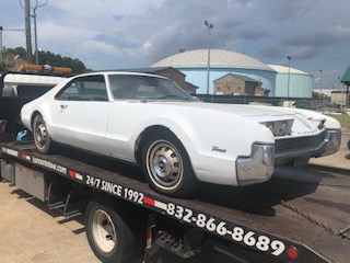

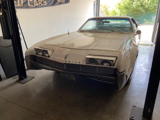

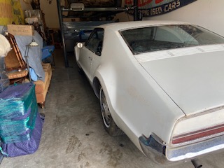

I wanted to share my update. I have attached a few images of the newly acquired 66 Toro. Went to warehouse and located the broken T-handle to release the hood. Had to get pliers to pull release. Success was short lived, it popped latch and hood raised up about an inch. However, the release at the latch/hood did not fully engage in order for me to lift hood with my hands. I will need some help to see if there is a adjustment to fully release latch.
For another day
I did order a service manual as you suggested.
Thanks all you 66 Toro owners!
Jim

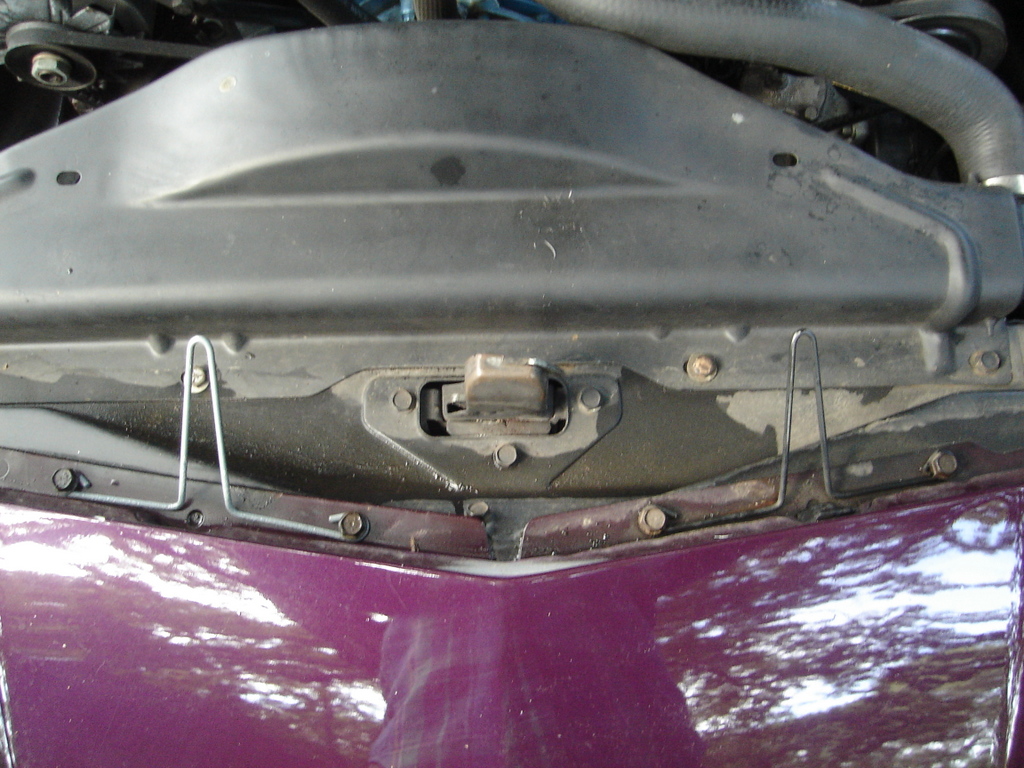

Close the hood all the way. Push it down so it's firmly latched. Then, pull the release lever and keep it pulled all the way out tight while you or a helper quickly gets his fingers in the gap and continues lifting the hood.
There is a piece of spring steel that helps push the hood open. These usually get a little weak with age. I installed a second one on my car so I now have extra oomph! to push the hood past the secondary latch.
I installed the one on the passenger side. Driver side is original.

Thank you for the tip. I will give your method a try. I need to find a helper to assist me. The hood seems very heavy.
