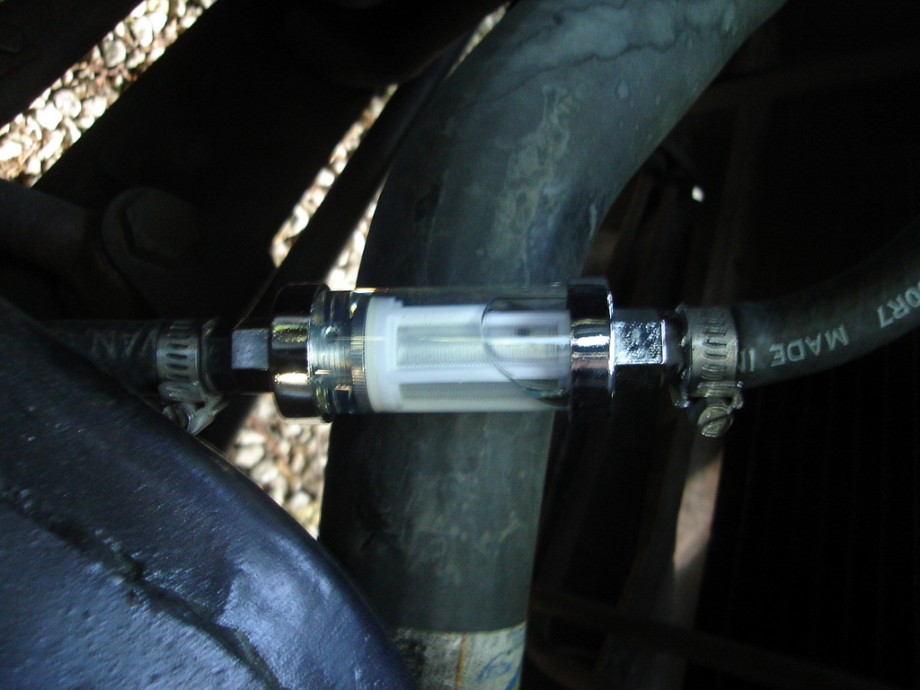

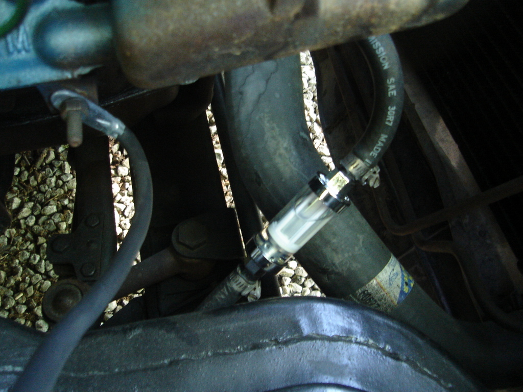

Regarding the fuel tank, I'd install a see-through, inline filter under the hood before it enters the fuel pump. That will give you a good indication on whether or not you need to do anything with the tank.
- DSC04099.JPG (378.34 KiB) Viewed 23417 times
- DSC04100.JPG (379.62 KiB) Viewed 23417 times
Re: 66 Toro arrives tomorrow
Thank you love the gas filter idea. Is there a radiator flush that you swear by?
