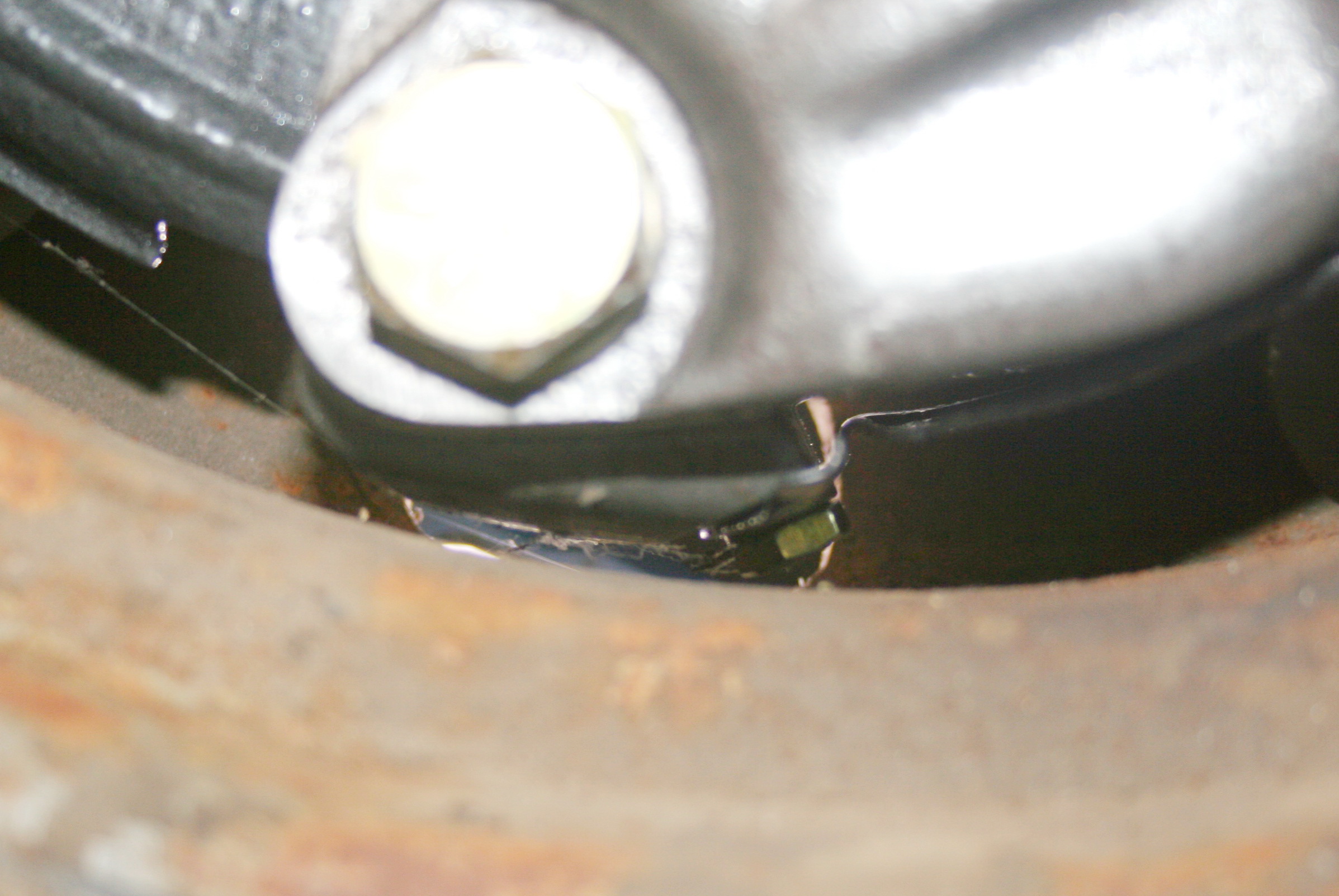

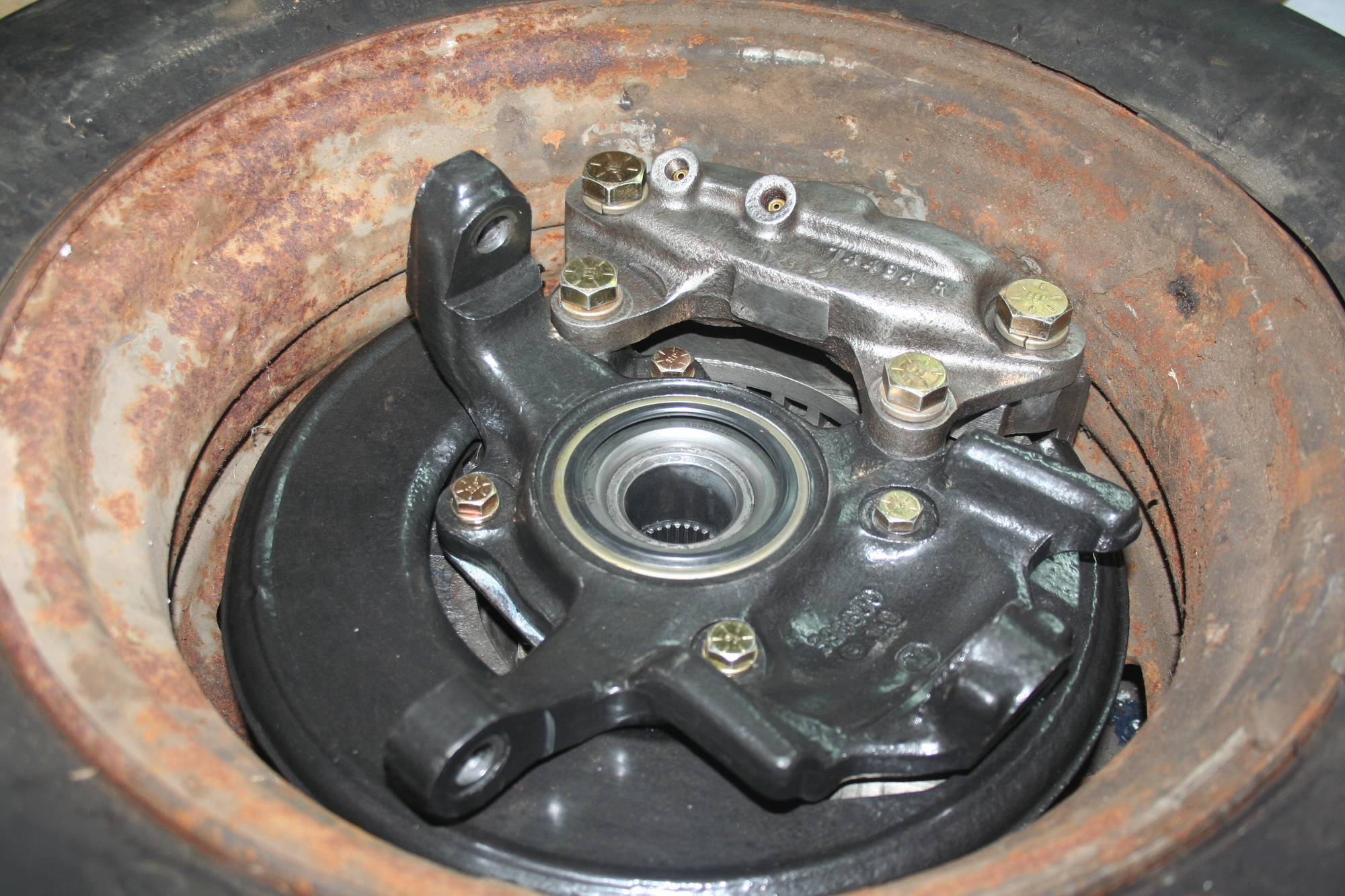

last set of pics

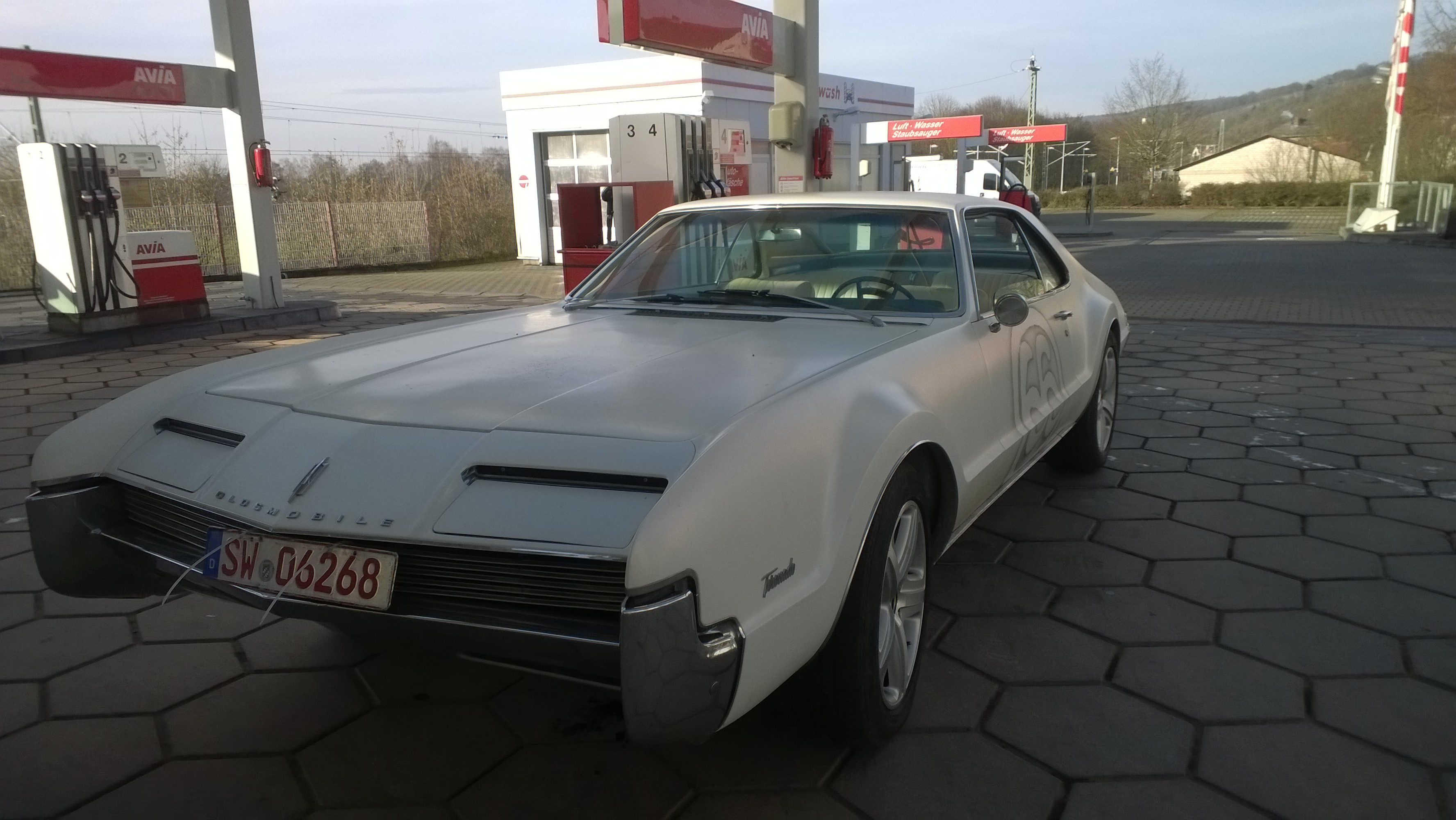

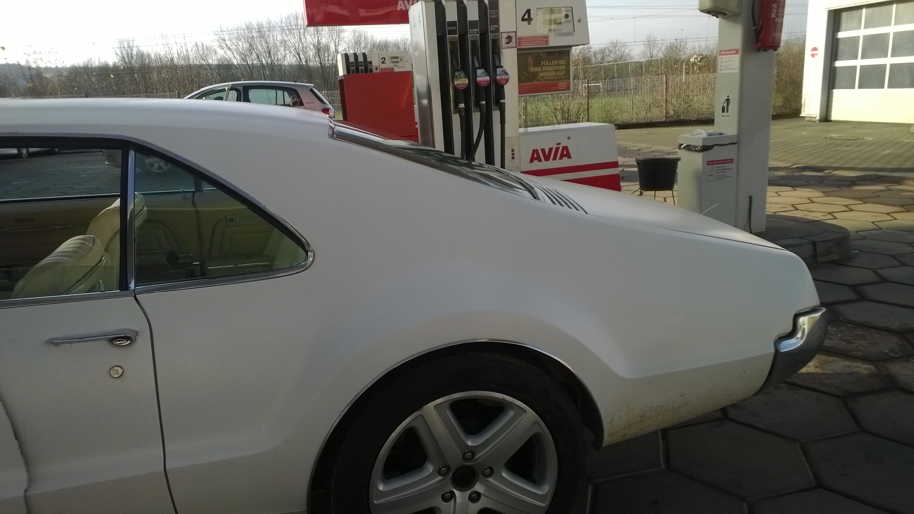

Toronado seen with Mercedes Benz G Wagon wheels

Hi Harold, good to hear from you again.
Do you now have 2 Toronados?
What did you do about the offset of the rim? The Tor, as you know, has a very deep backspace. Is the G-Wagen the same?

Hi Otto,
no I still have only one Toronado... and that keeps me busy enough..
The white Toronado was bought from a friend of mine. He didn't buy those G -Wagon wheels, instead he took the car with the standard steel rims. I only know that those rims were on the car at some time but more than they came off a Benz G- Wagon is not known. Sadly no info on size, backspacing and such. That's bad, ' cause those G-Wagons had some designs you could see on a Toronado without hurting ones eyes.

I'll find the wheel specs. Without proper backspacing, serious damage can be done to the spindles/bearings, etc. You probably already know that, though.
Here's the wheel information:
Bolt Pattern 5 on 5"
Width 6 inches
Offset +3.25 inches
Backspacing 6.75 inches
Load Rating 1600 pounds
Width 6 inches
Offset +3.25 inches
