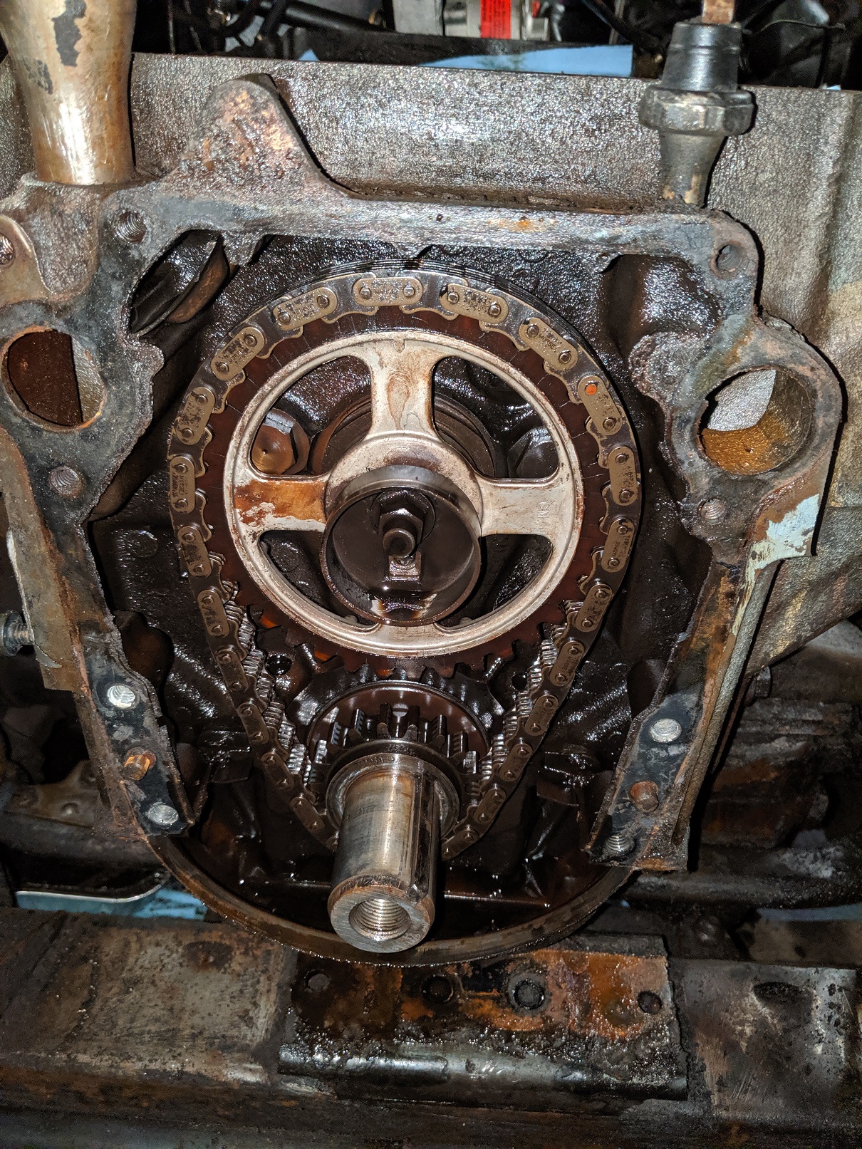

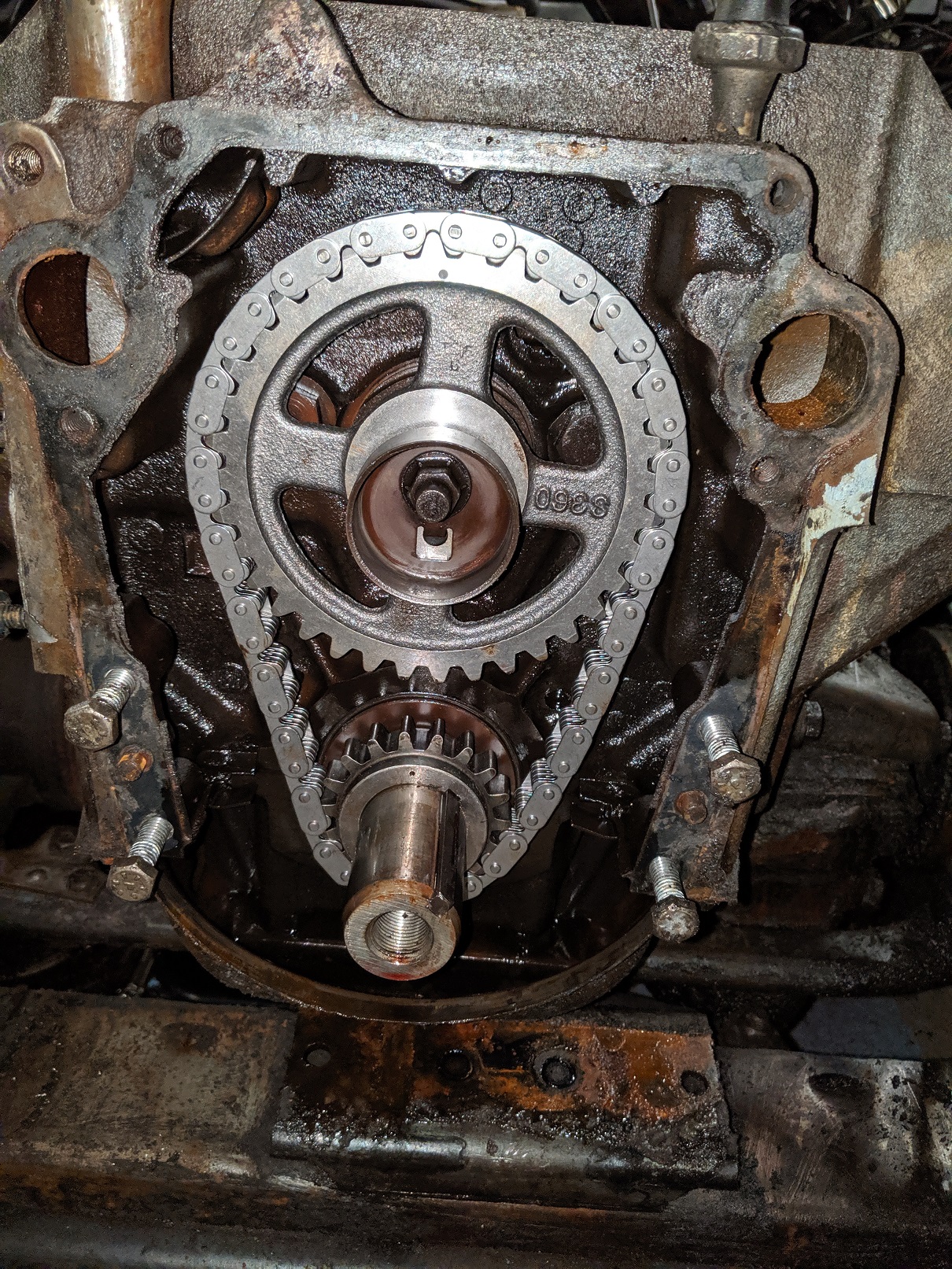

As you told me, I checked and replaced the timing chain and the whole set. It was not that bad but it's still good to do. Not that easy when you don't want to remove the engine from the car, especially because of the front mount of the engine but I was able to lift the engine with a jack just enough to remove the front mount and have access to the chain.

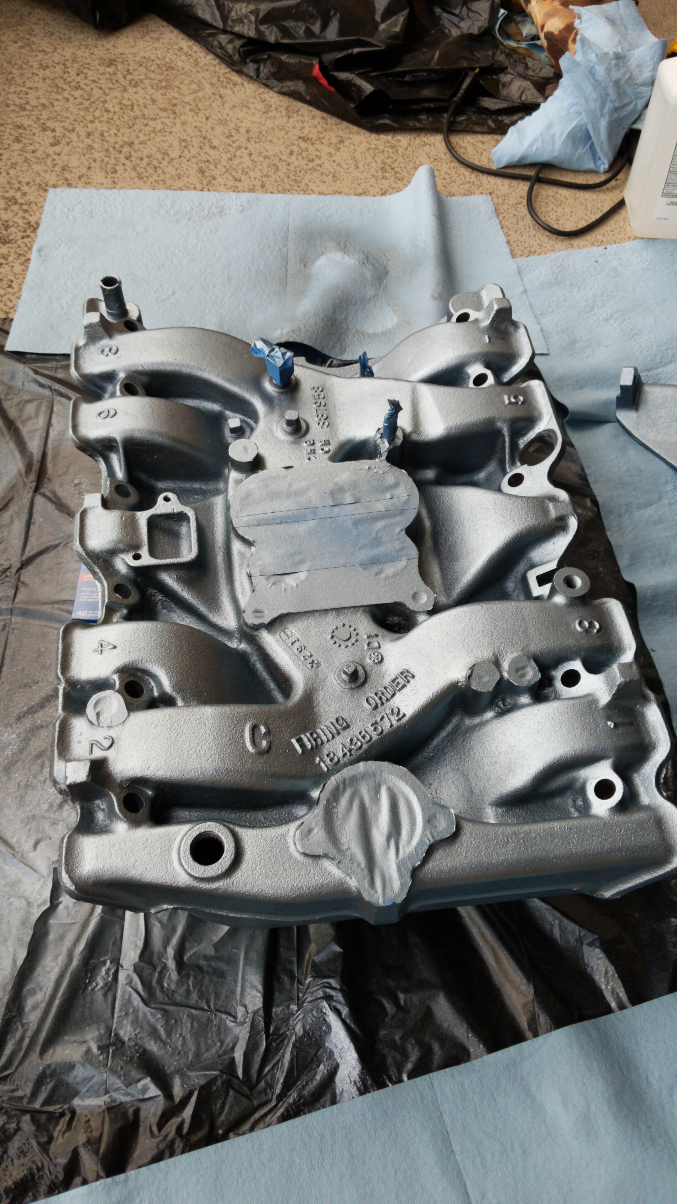

I'm also cleaning and painting the engine back to it's original color, found a lot of infos everywhere so I said... why not :)

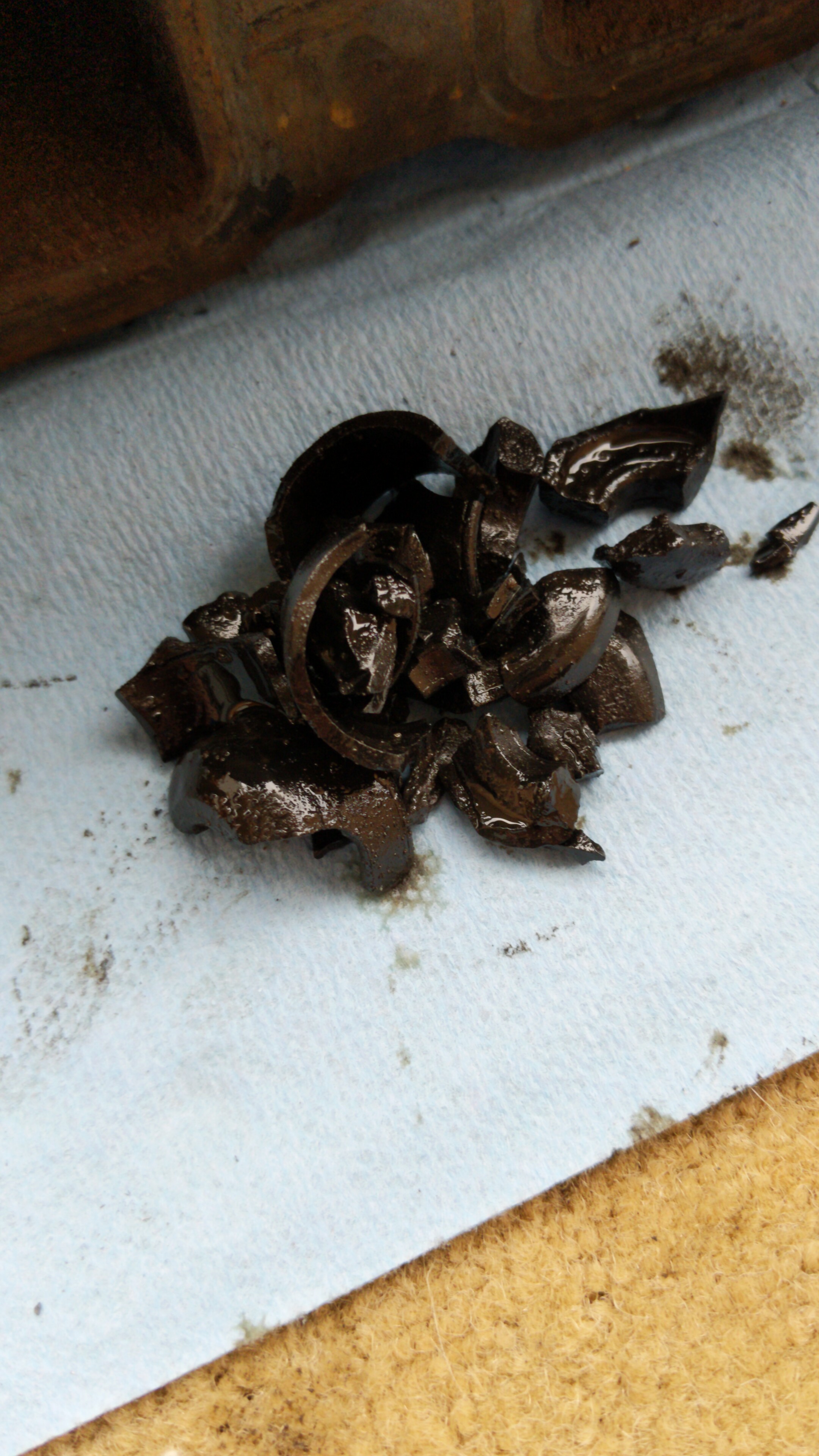

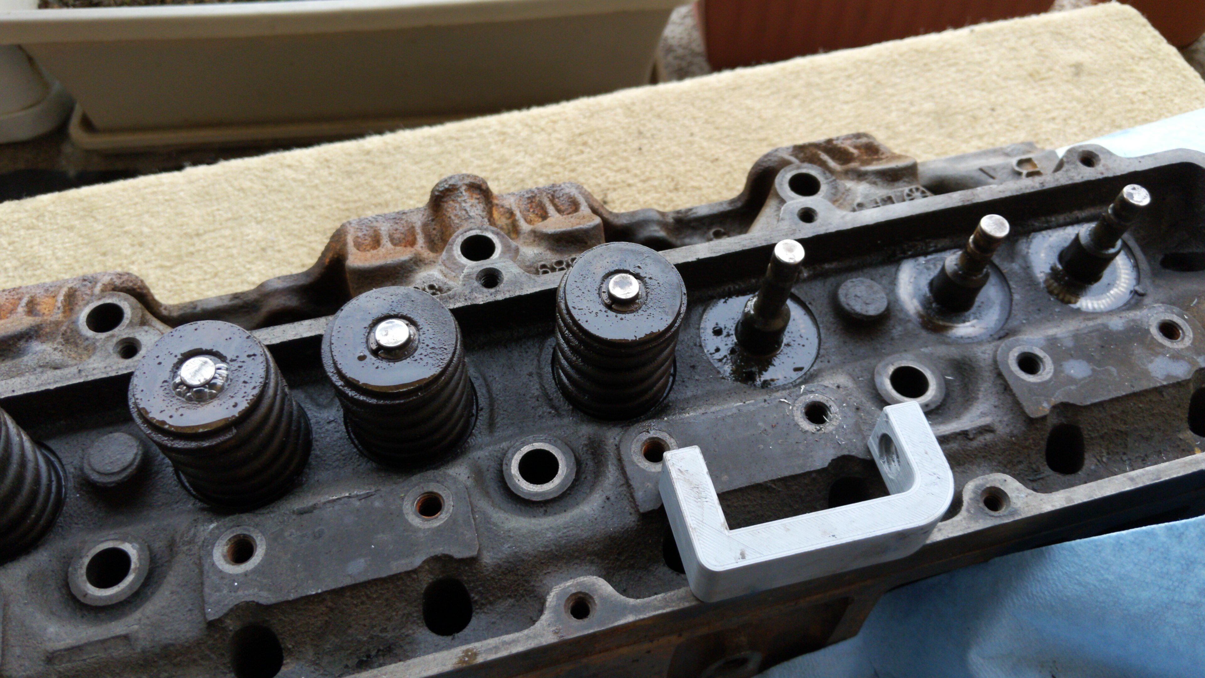

I also changed the valve sterms, they were all in pieces... so I was afraid it could go in the oil pump, and I cleaned the oil "canal" on the cylinder heads that were full of debris.

I used the timing set from Cloyes https://www.rockauto.com/en/moreinfo.ph ... 82&jsn=482 , they seems to be the best for that. The older one looked original but I cannot tell for sure. It did have nylon on it and still in a good shape.

Valve seats were looking good, did some small grinding just to be sure, springs and valves were perfects.

Next step is to clean and paint all the parts, then put everything back in place.

Nylon means it is original. I have always managed to change the timing
set without removing the engine or the oil pan, that DIY procedure is NOT
in the book. I have seen steady wear into the nylon, the chain keeps
getting looser with miles. But that is not the danger, rather the YEARS
will cause the nylon to fracture and fall off without warning, possibly
destroying the engine. Bruce Roe
