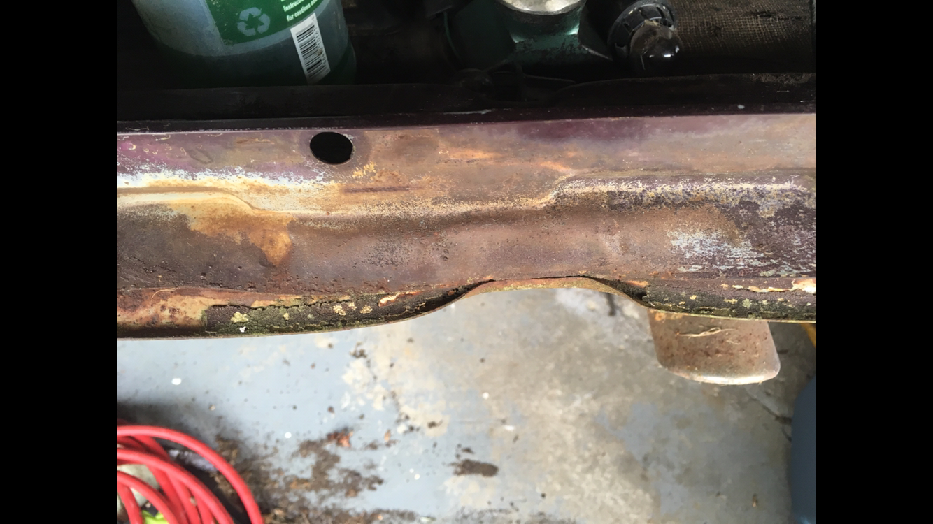

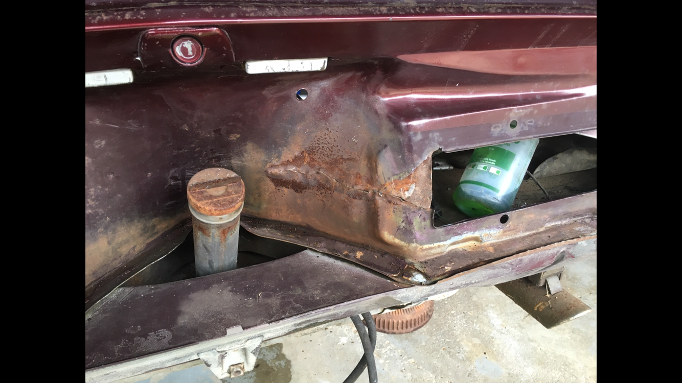

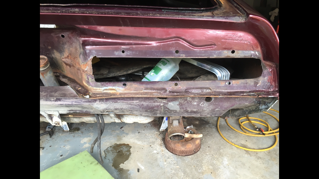

Wow - October was a blur - and none of it was in the garage. But today I finally scored some quality time with the big gal.
The taillight panel had a big gash and a dent where it looked like someone backed into the car. So I borrowed a dolly from a buddy down the street, grabbed a regular hammer, and started straightening some metal. It still needs welded, but I thought it came out pretty good all things considered. As you guys know, the repair will be completely hidden behind the huge panel that covers the entire rear and surrounds the tail lights.

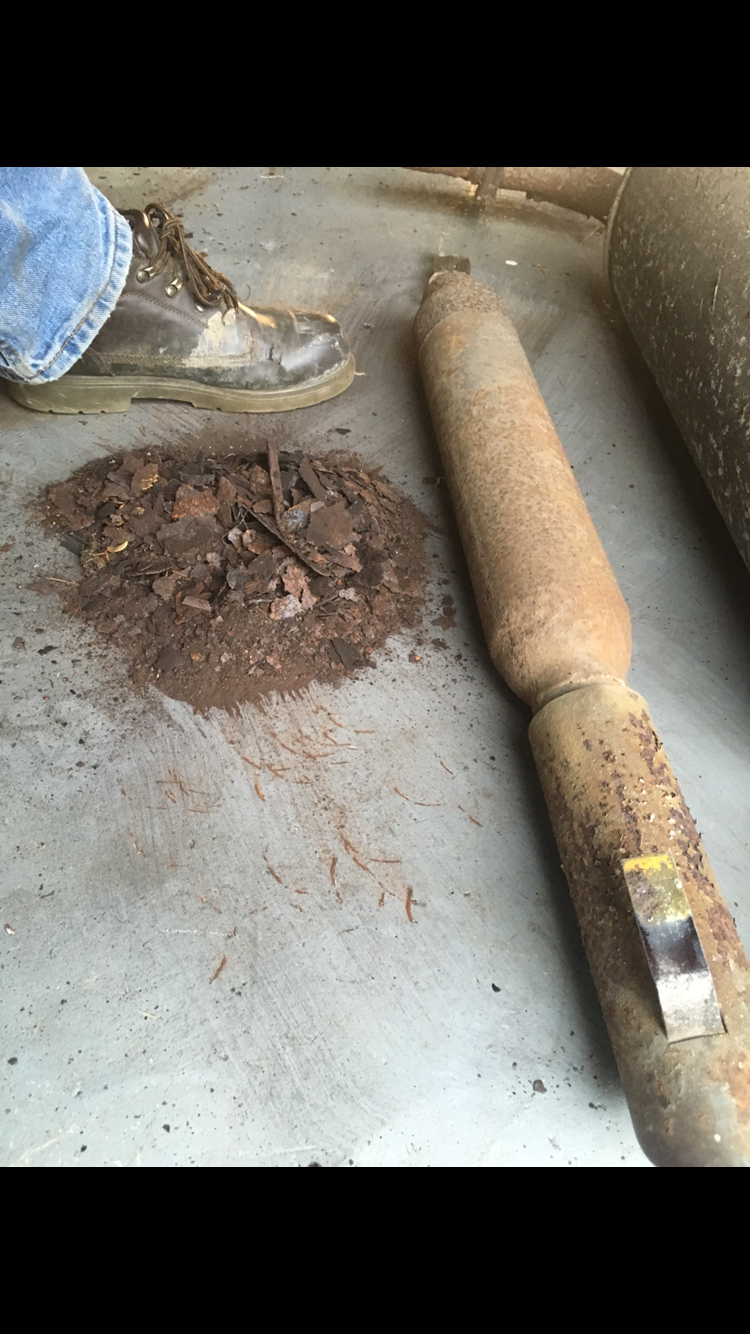

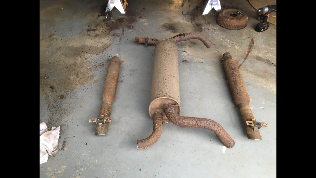

Next on the list was the exhaust. Each resonator had a LOT of rust inside. See the last pic - that pile is from ONE resonator. The whole exhaust system is toast. Hopefully I can find a Borla muffler that will fit. Right now I'm not sure if I will replace the resonators or eliminate them altogether. I found a set of used 4" Borla tips that might just be perfect.

Good job on the metal repair. Probably could seal it up with JB Weld! (kidding, of course)
Anyway, don't throw away your exhaust tips. They can be rechromed. Also, I think you should keep the resonators. They make for a very pleasing sound.
Search this forum. They is a person here who has made all new exaust tips and resonators for sale. They are as close to original as possible.
I notice that you will be needing a new gas cap. Be sure to buy a NON-VENTED cap. This is specified in the manual. Someone had installed a vented cap on my car and on a hot summer day gasoline would exit the vent hole and condense all around back there and stink up the whole car.
