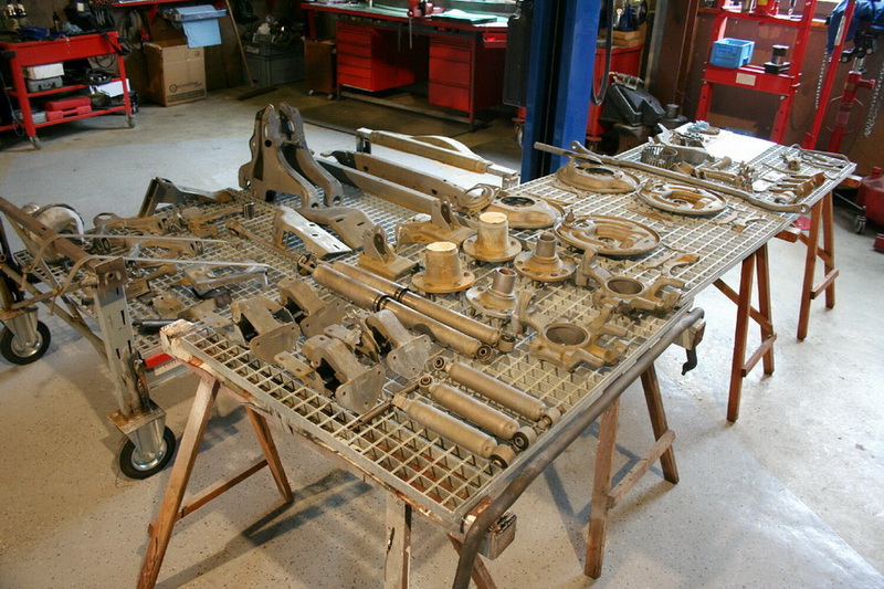

some more earlier pics....it feels good to see some real progress

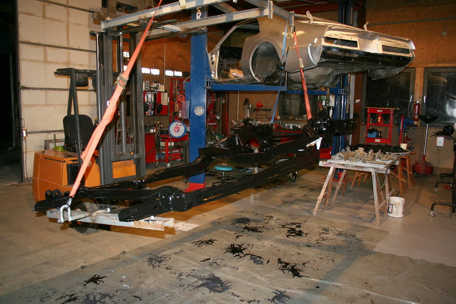

- parts ready after a treatment with rust blast
- IMG_8294.jpg (211.33 KiB) Viewed 80449 times

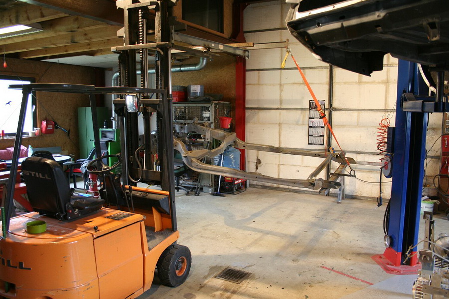

- frame painted with two coats of KBS coating , the outside AND the inside!
- IMG_8318.jpg (237.33 KiB) Viewed 80449 times
- Frame ready for paint

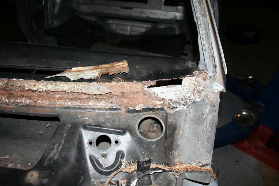

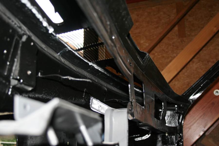

- another highlight of corrosion...rear window
- IMG_8511.jpg (175.88 KiB) Viewed 80449 times
- an old repair...
- IMG_8503.jpg (158.52 KiB) Viewed 80449 times
- IMG_8372.jpg (169.2 KiB) Viewed 80449 times

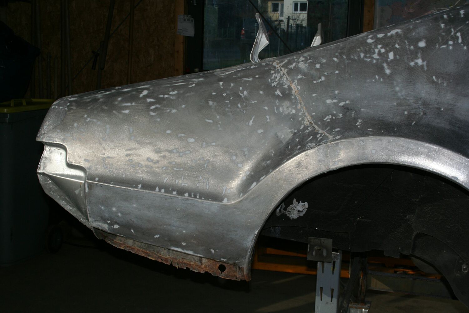

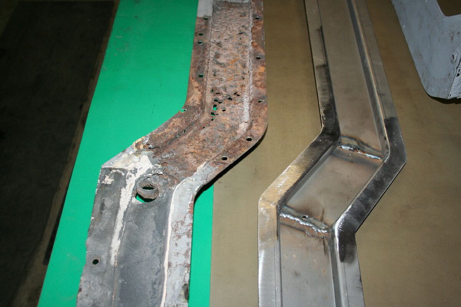

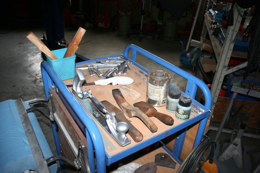

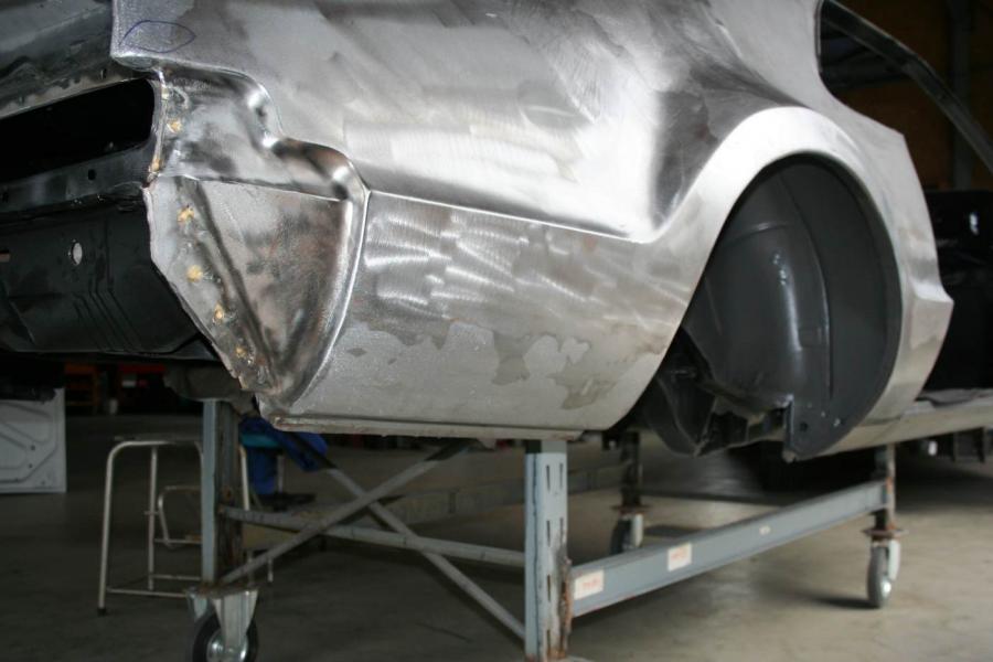

Some pics of the ongoing work on the Toronado. So far I started the lead work, repaired the Dash / front windshield frame and some other parts..
Harald
Harald
- IMG_8503.jpg (158.52 KiB) Viewed 80272 times
- IMG_8965.jpg (48.96 KiB) Viewed 80272 times
- IMG_8993.jpg (74.43 KiB) Viewed 80272 times
- harascho
- Posts: 106

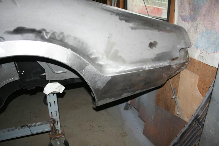

and more of the lead work
- IMG_8966.jpg (54.23 KiB) Viewed 80272 times
- IMG_8991.jpg (52.63 KiB) Viewed 80272 times
- IMG_8984.jpg (46.44 KiB) Viewed 80272 times

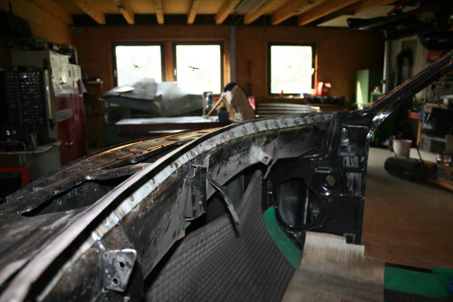

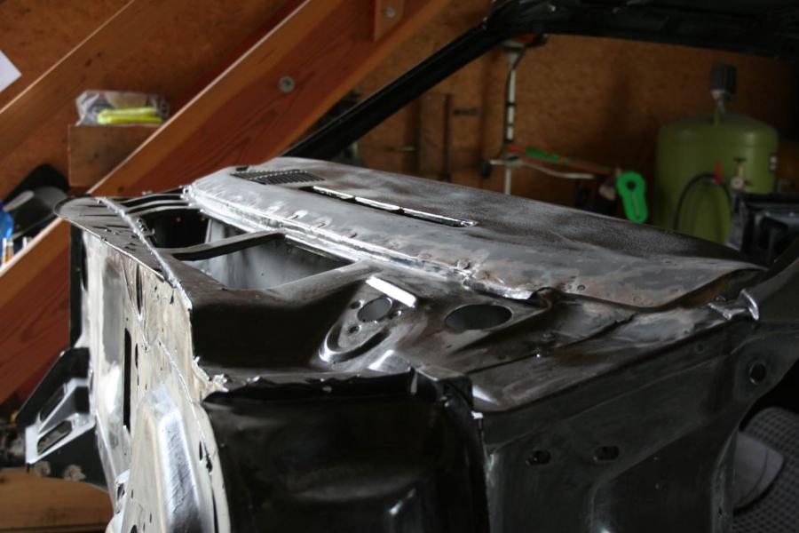

and here are some pics of the repaired front windshield frame
- IMG_8978.jpg (57.97 KiB) Viewed 80272 times
- IMG_8929.jpg (67.66 KiB) Viewed 80272 times
- IMG_8926.jpg (64.51 KiB) Viewed 80272 times
- harascho
- Posts: 106
and the finished frame
- before
- windshield_3.jpg (71.58 KiB) Viewed 80272 times
- after
- IMG_8976.jpg (56.99 KiB) Viewed 80272 times

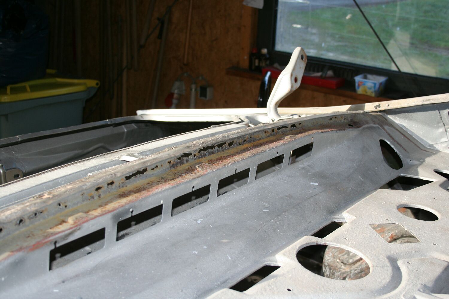

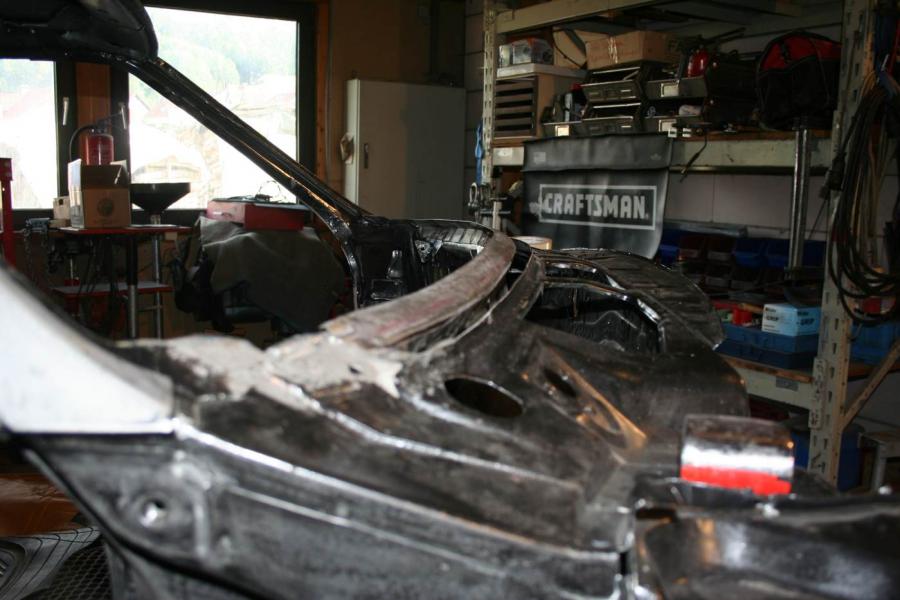

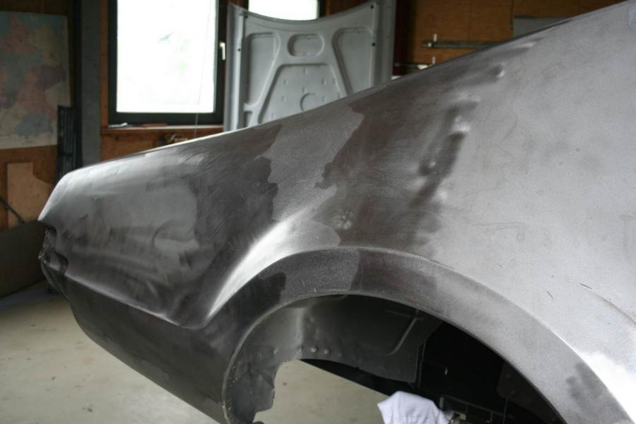

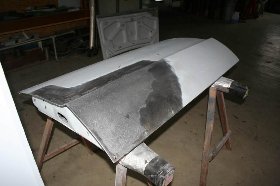

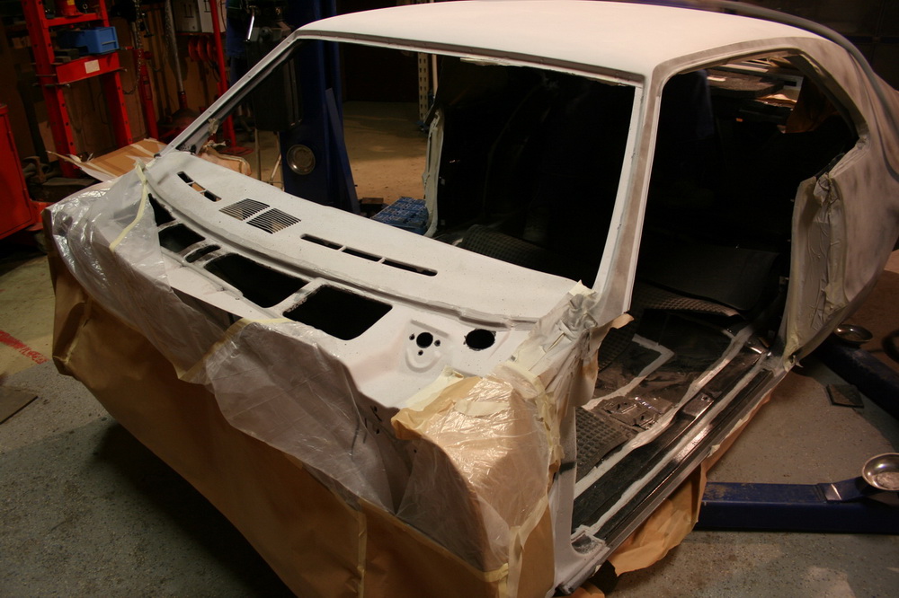

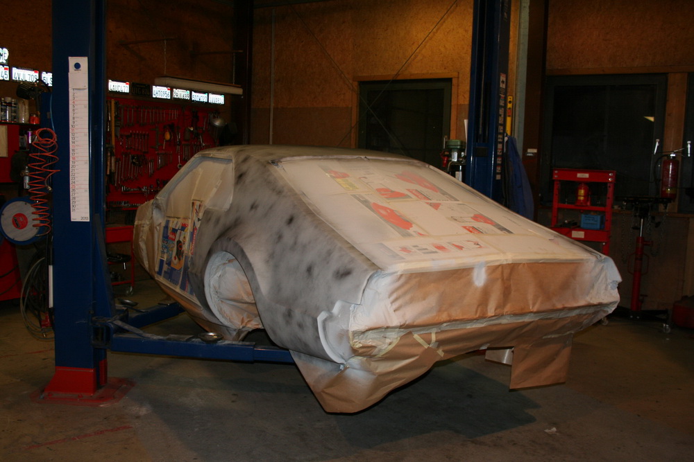

just a brief update:
Toronado is in paint preparation. After the lead work a buddy of mine is working on perfect straight sheetmetal. We hope to get it painted bey the end of this year.
In the meantime I started on the engine. I had luck and it really was "overhauled": new timing chain, new valve train, new main bearings, a bored / honed block with new pistons... So my work will be only cosmetical...
Harald
Harald
- dash_1_S.jpg (224.5 KiB) Viewed 80061 times
- paint_prep_S.jpg (204.63 KiB) Viewed 80061 times
