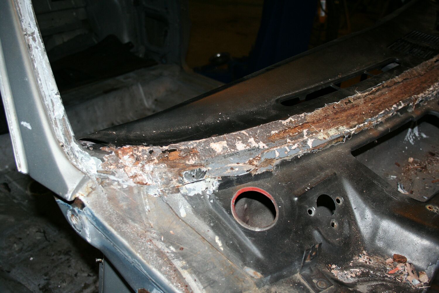

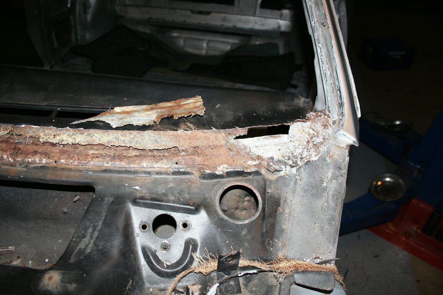

some more pics.... and one of the worst area I found so far, the front windshield frame.
Does anybody have a solid Dash for me??
Harald

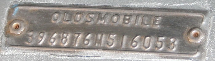

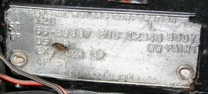

Some info on the car, probably someone can help decode them.....
Harald

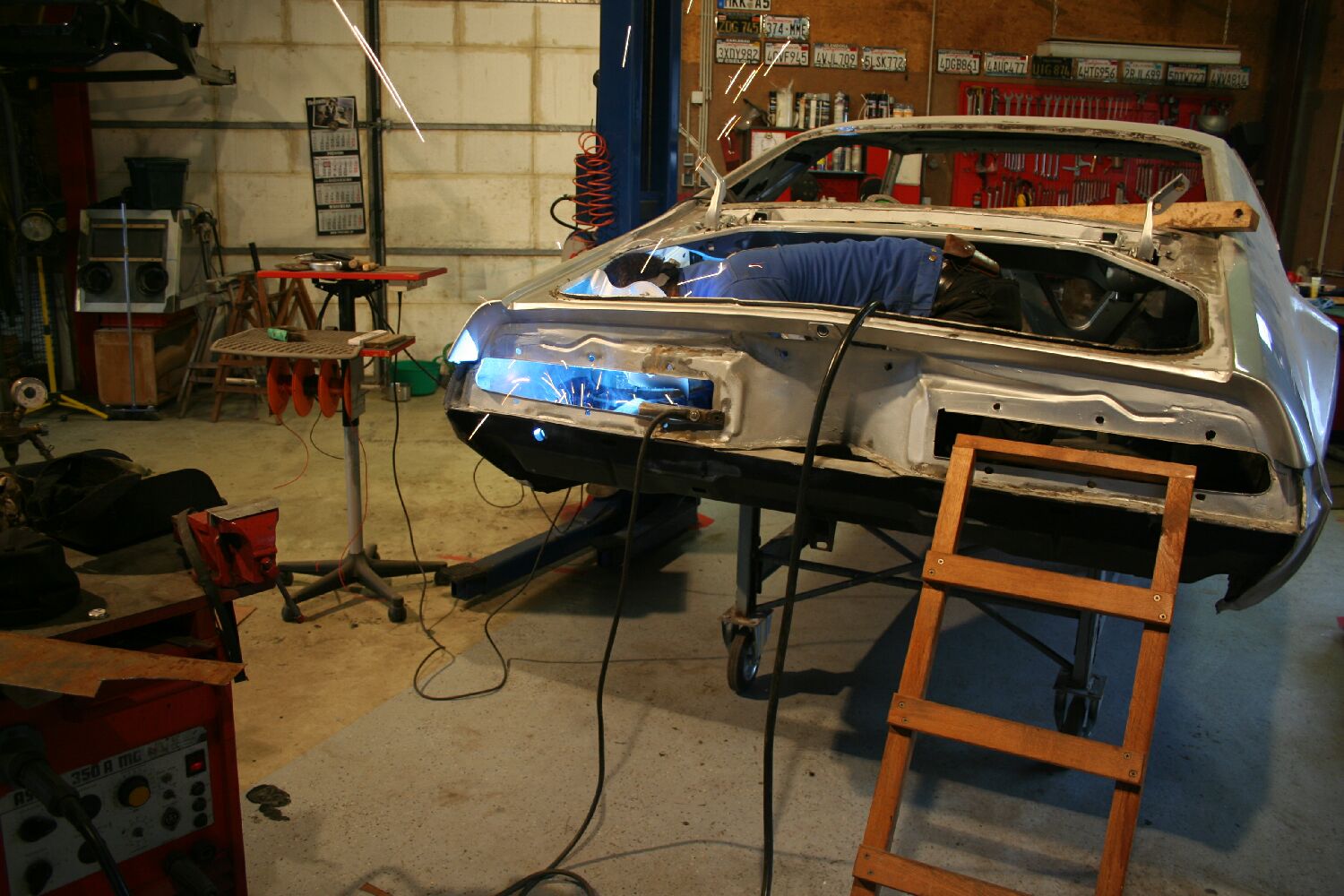

some pics of the work done..
Harald

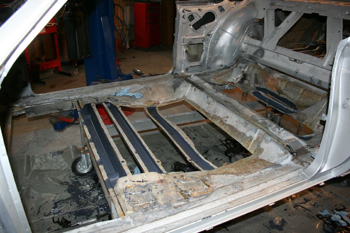

Postby harascho » Sat Jan 19, 2013 12:05 pm
and some more pics

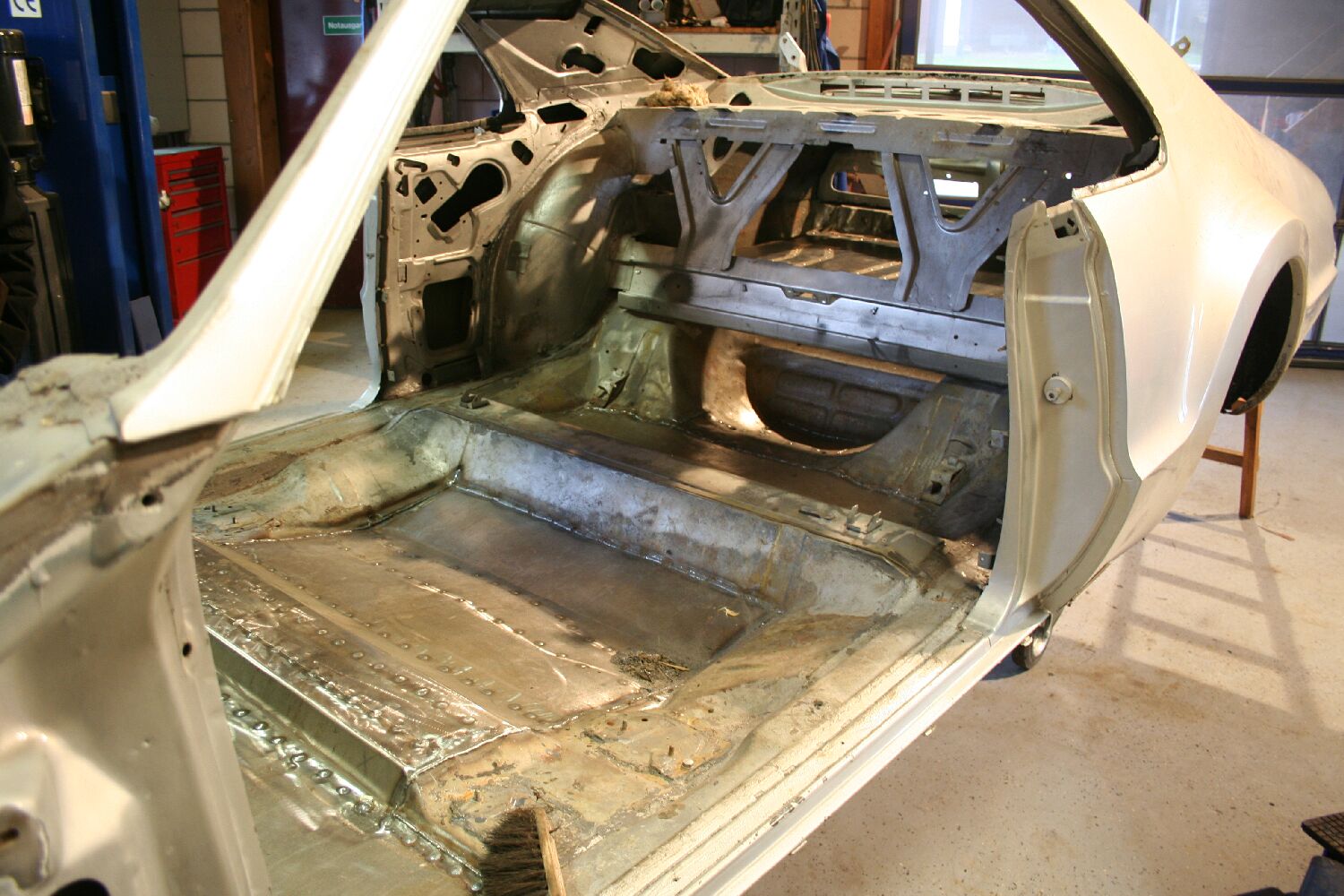

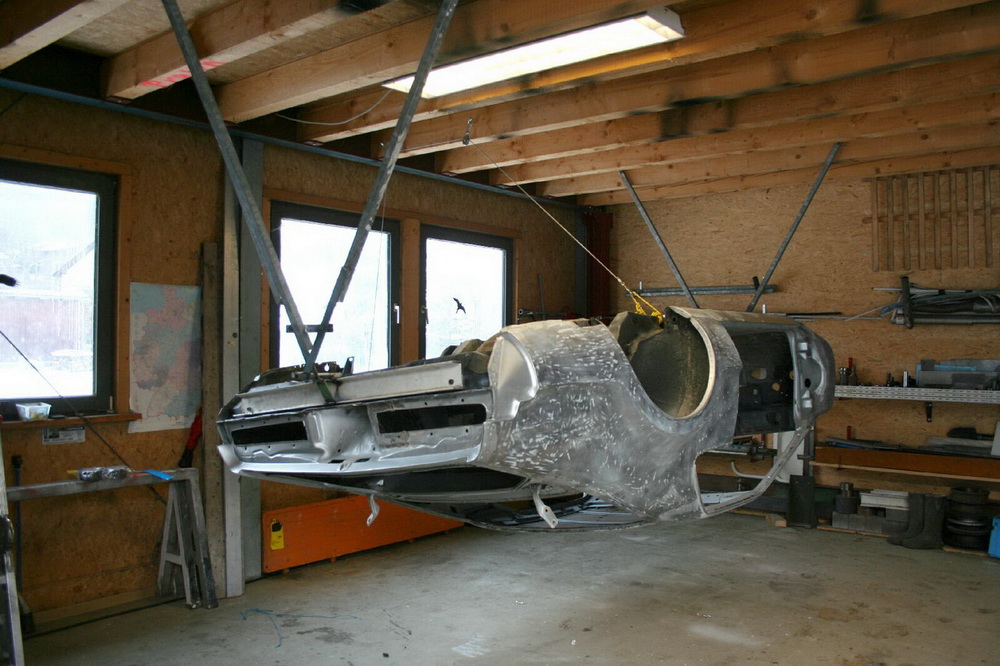

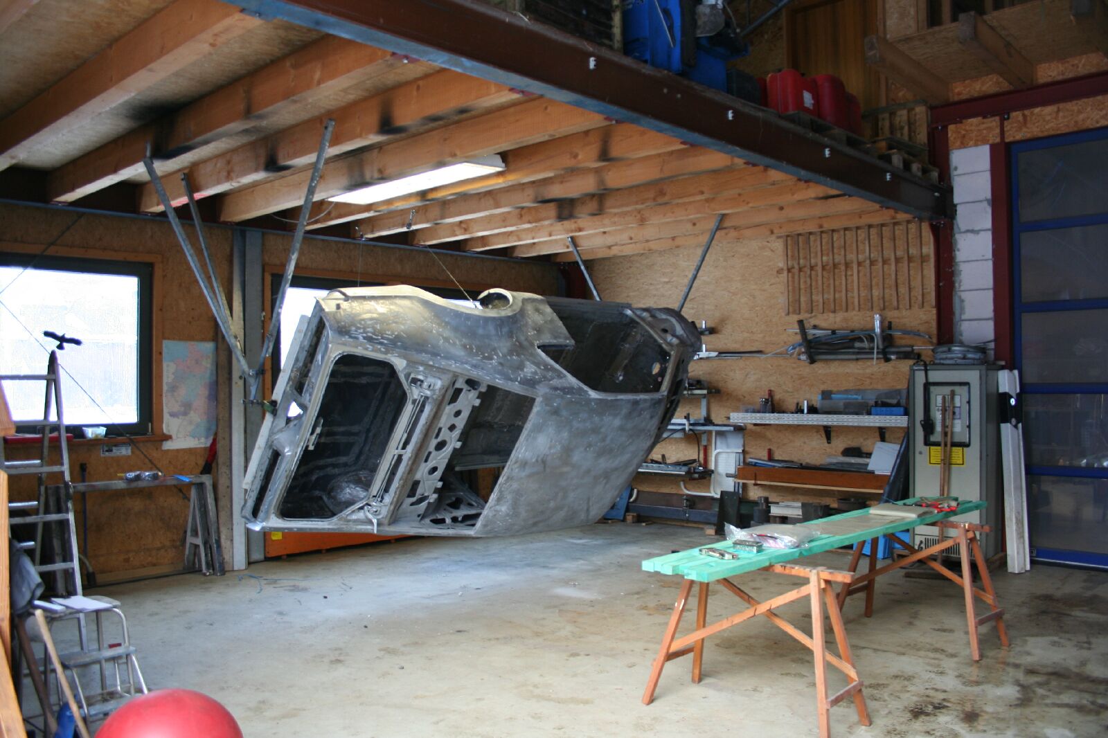

Postby harascho » Sat Jan 19, 2013 12:12 pm
And here the last ones... situation as of today, rotisserie finished.... all ready for sandblasting
Harald
Postby Doc Hubler » Sat Jan 19, 2013 9:26 pm
Harold,
I really like the rotisserie you set up! I wish that I had saved the dash piece from my 67 parts car -- you really could have used it as your car was rusted out. I makes me determined to find a way to save more of this stuff if I can because you never know when you'll need it. Keep up the amazing work and please keep posting pictures of your progress.

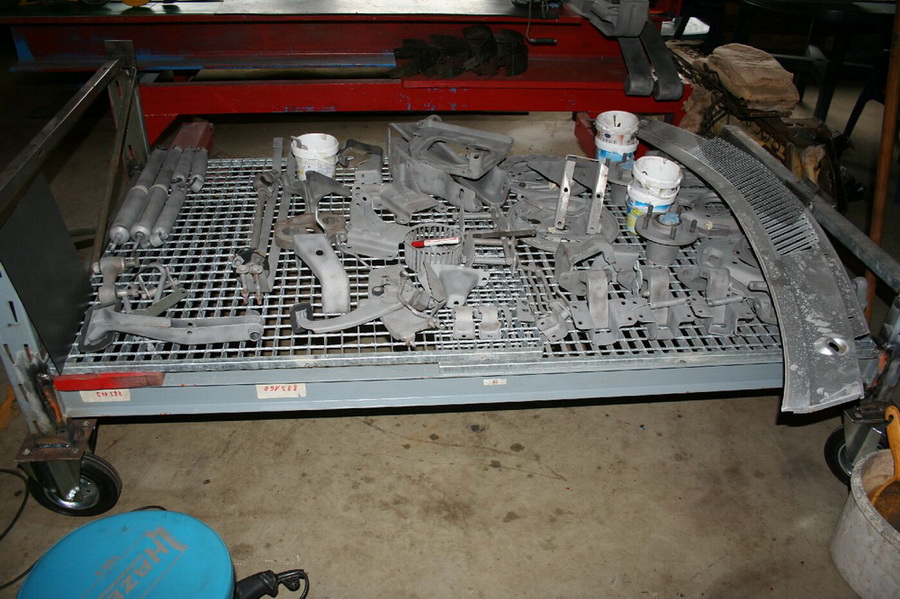

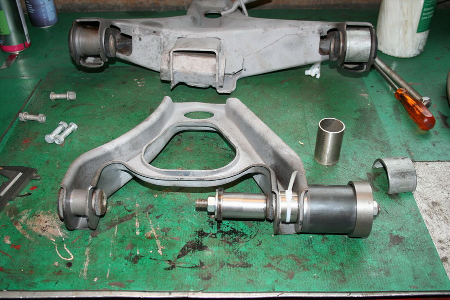

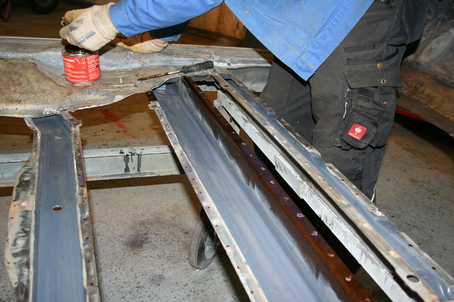

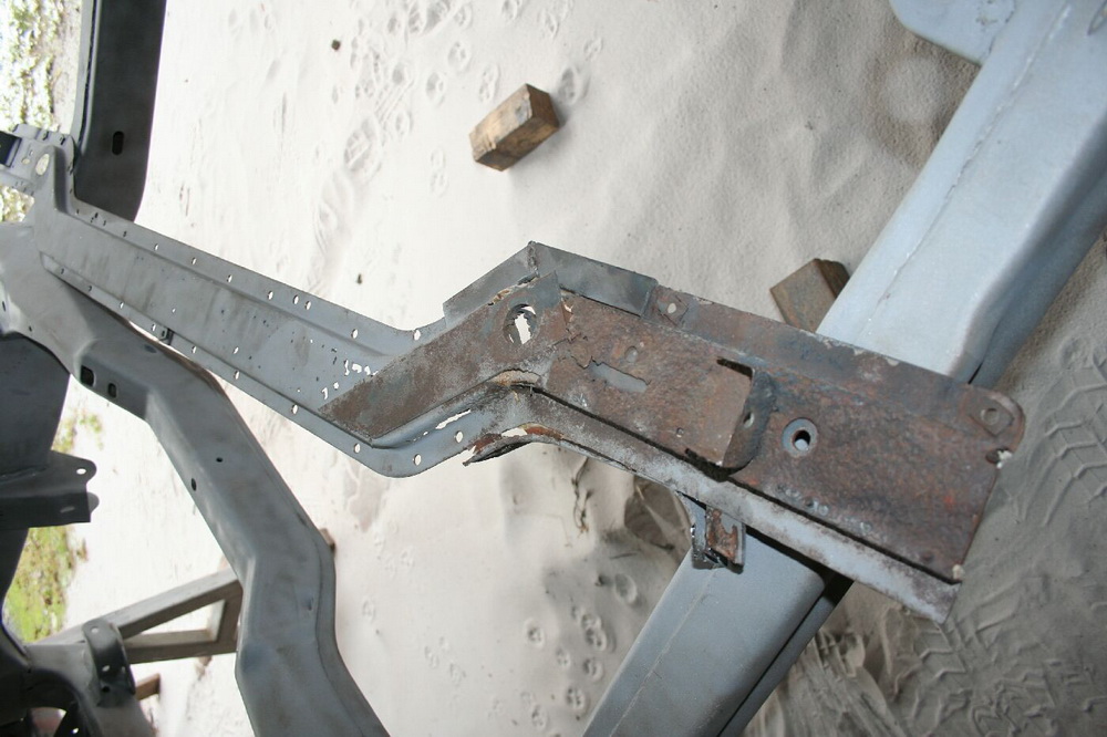

Some earlier pics, parts which are sandblasted and awiting a treatment with KBS coatings.
The pic in an older message contains a welded hub. My front wheel bearings were shot, one inner race was turning on the hub instead within the bearing itsself. I had to weld the Hub and turn it back to spec in a lathe.
Harald
parts reasdy for KBS preparation
removing the upper A-Arm bushings
