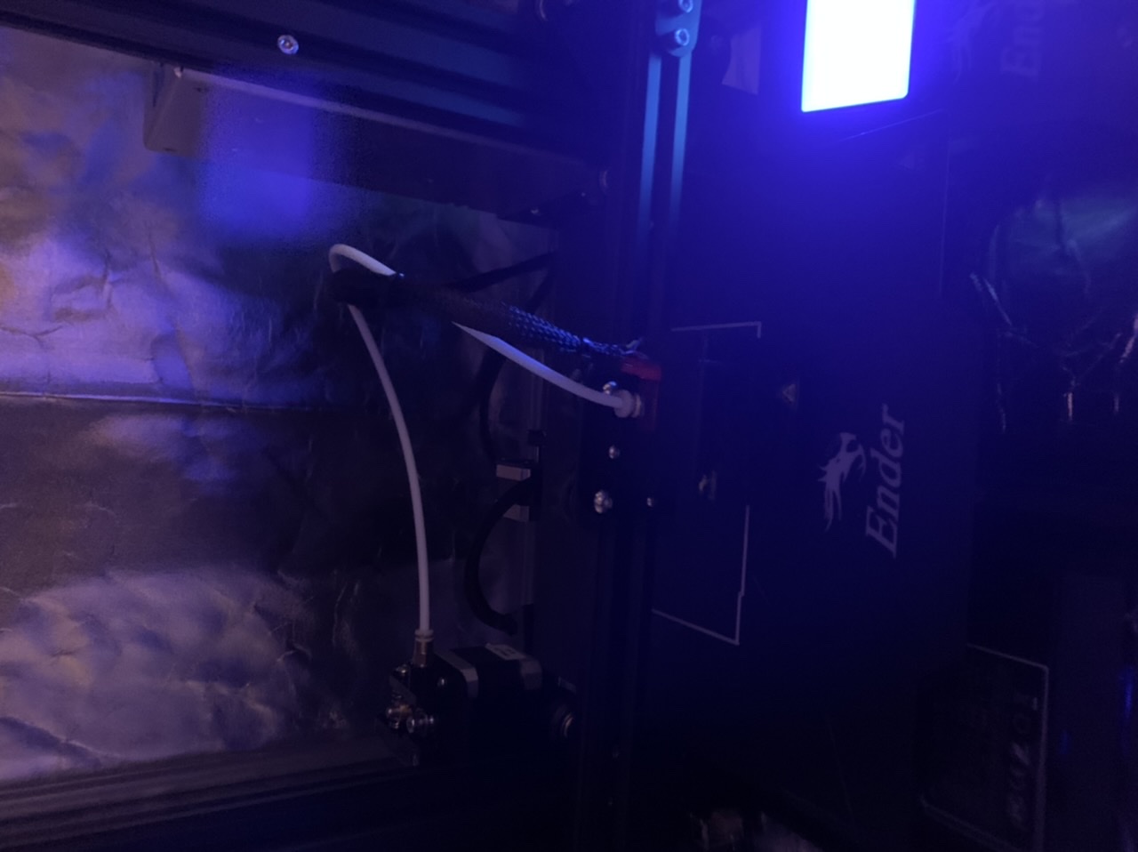

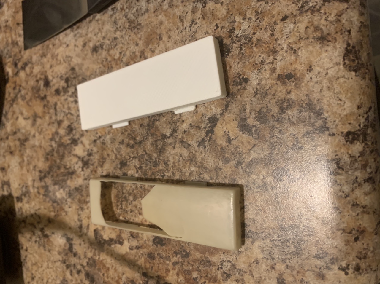

So I’ve decided to create my own replacements for my Toronado’s door panel light lenses since one was cracked and the other was just a cheap plastic film. The final version has a couple of imperfections, but it’s normal when the thickness is very small. Overall, I think it came out quite well and should allow more light to pass through compared to my first two prototypes (they were thicker). Plus, this one feels sturdier than the OEM part (less likely to crack). Will update tomorrow morning when the second lens finishes printing and when I test fit/install both of them.

Postby NicolasB » Sun Dec 13, 2020 8:12 am
Yeah! I’m using an Ender 3 Pro. 3D printers are honestly worth the investment for projects like these. For for the courtesy light lenses in the back, they cost almost $30 in Fusick, but can cost significantly less when you make them yourself (1kg roll of filament is between $20-25 on Amazon). On top of that, it will be possible to manufacture parts that are hard or impossible to find.

I believe the printer was $300, but there alternatives that cost less (downside is they can’t make large parts). Now there is a tool that can scan and render parts into a software program (I’m not sure if it can detect actual dimensions), but it could set you back a few hundred dollars the last time I checked for one. What I did was take the original lens out and used a caliper to define the dimensions. I started out with a sketch then created a model in SolidWorks. I’m still not sure what to do in the case of missing parts, but I might create a template or do something similar with the calipers. My dad’s F-85 is missing a pair of back-up light lenses so I might try to eyeball it and use the calipers to measure the size of the socket. After the modeling stage, I usually create prototypes and try to fine tune the part for the best results.
