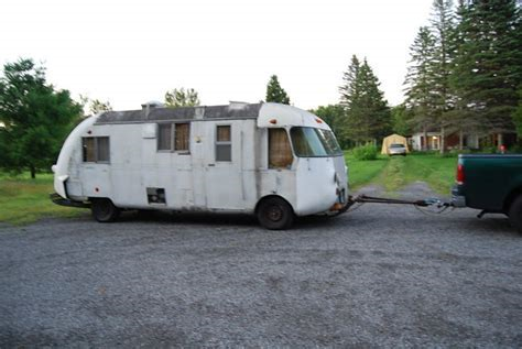

UV520 Towed to its new home.png (204.18 KiB) Viewed 35860 times

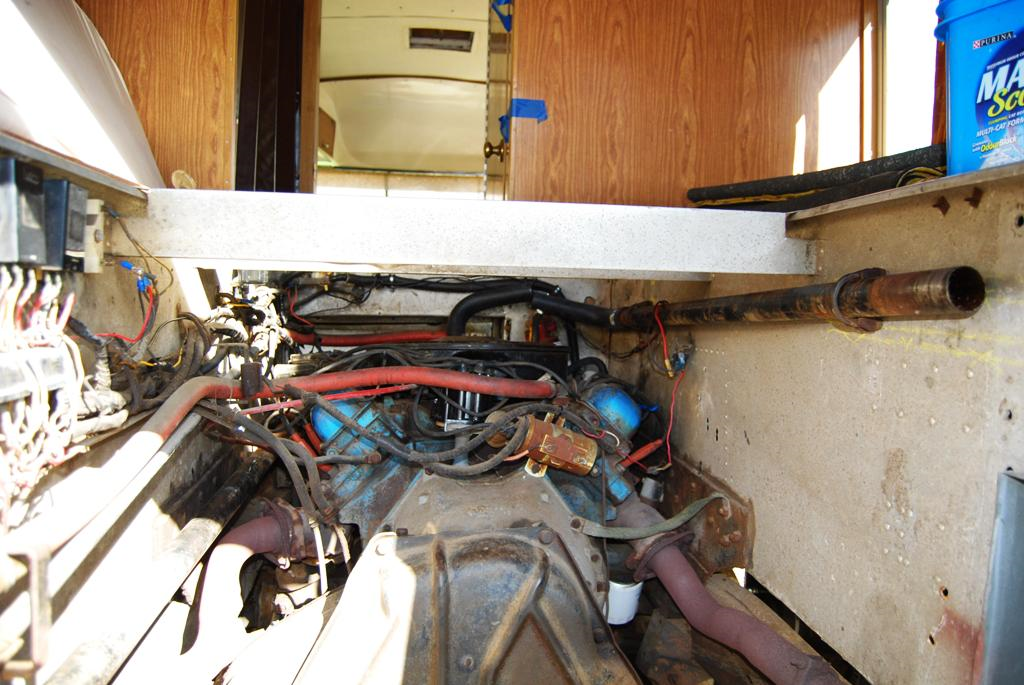

455 in UV520.png (1.11 MiB) Viewed 35860 times
