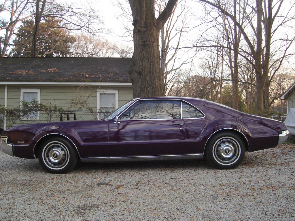

235/75 R15 radials are the correct size. If you want a 1" whitewall, you'll have a little searching to do. If you want a blackwall, your choices are endless. Originally I think the whitewall width was 3/4".
Or contact Diamondback tires and they will vulcanize any width whitewall you want on any brand tire you choose.
https://dbtires.com/
My car has Firestone radials on it.

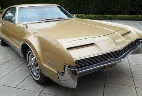

I am having a little trouble finding my way around this Forum. Part of the problem is that I am not mechanically inclined. Is steering dampener the name of a part? Where can I get it? My car will look like this when I polish it. Well, close...
