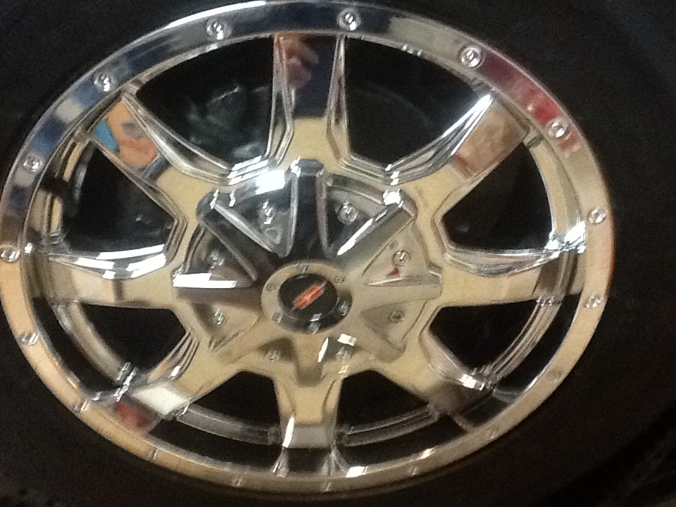

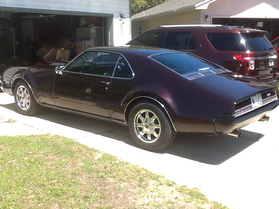

Finally got the wheels on La Sancha looks pretty good. :roll:

Not bad looking. Those are the ones you had custom made, right? What size rim and tire?
What did they charge to make those for you?

They are 17 x8 with Michelin 235/65-17 104H. They are not custom made just drilled and machine with a large offset. I am only in to them wheels and tires about $1,800. All done. I think it was a good deal. They still sit out a bit more then I like but don't seem to be putting to much pressure on the bearings. Time will tell. :roll:

That's pretty cool that you found an Olds center cap emblem that fit them.
These are the specs for Toro wheels so you can compare the backspace and offset measurements.
Bolt Pattern 5 on 5"
Width 6 inches
Offset +3.25 inches
Backspacing 6.75 inches
Load Rating 1600 pounds
