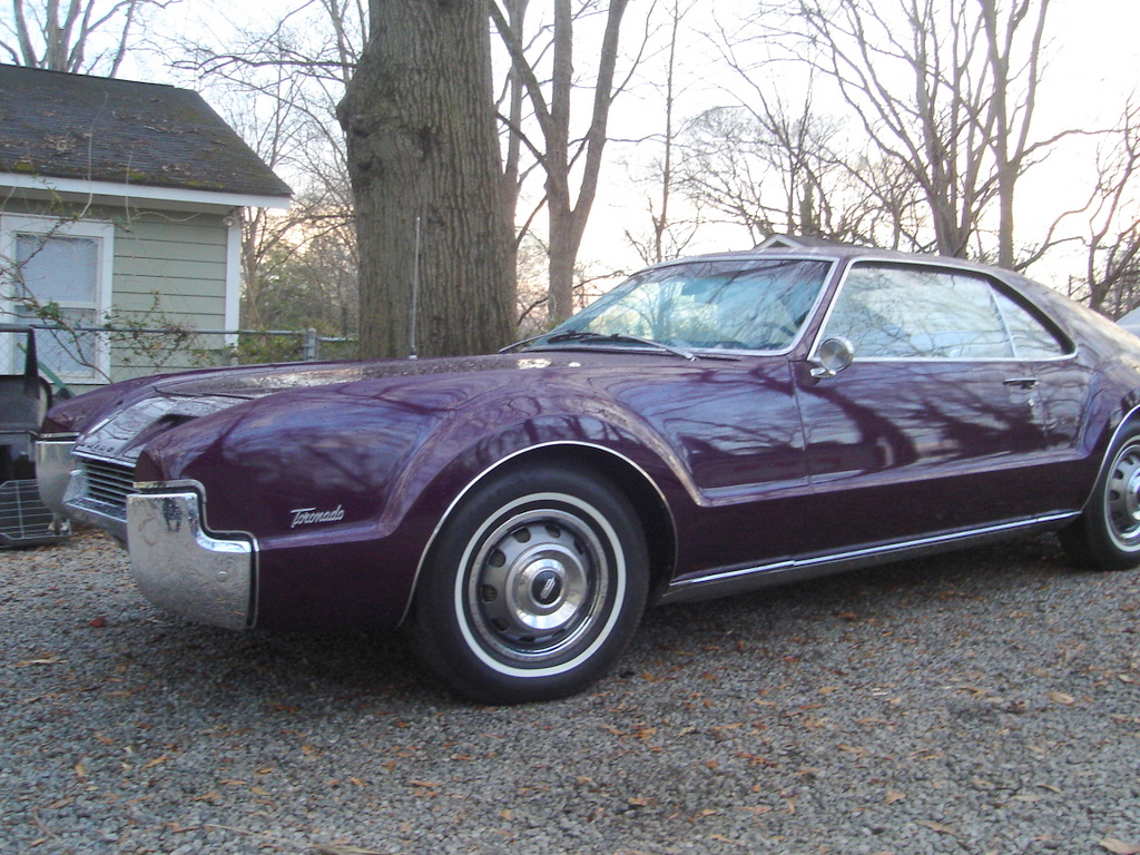

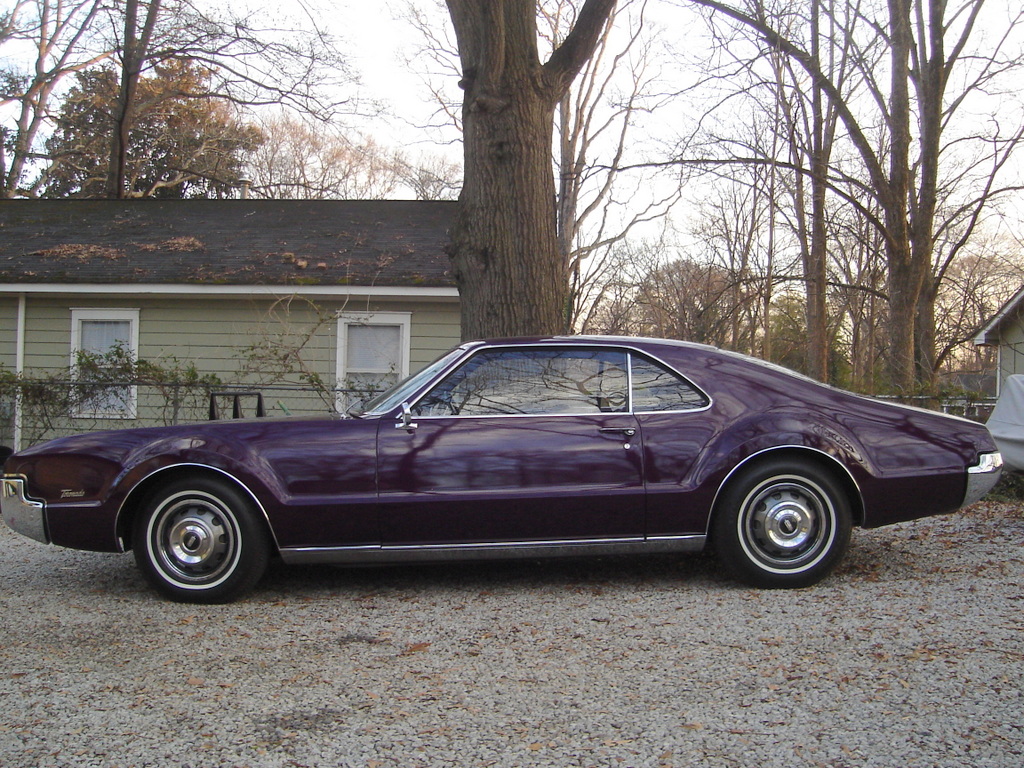

Mine has 235 -75 whitewalls on it. They fill up the wheel well without looking freakishly large or too small.
