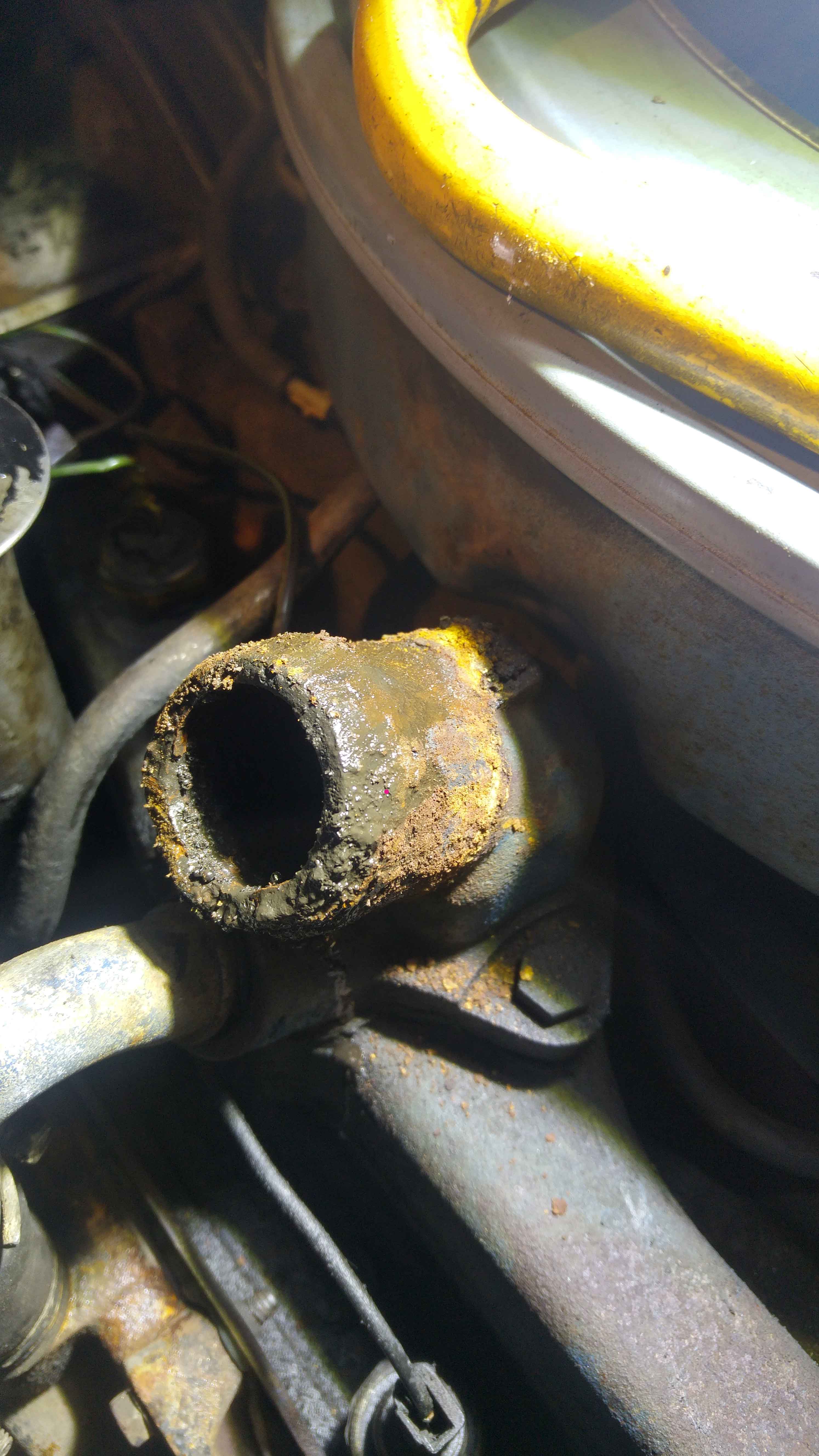

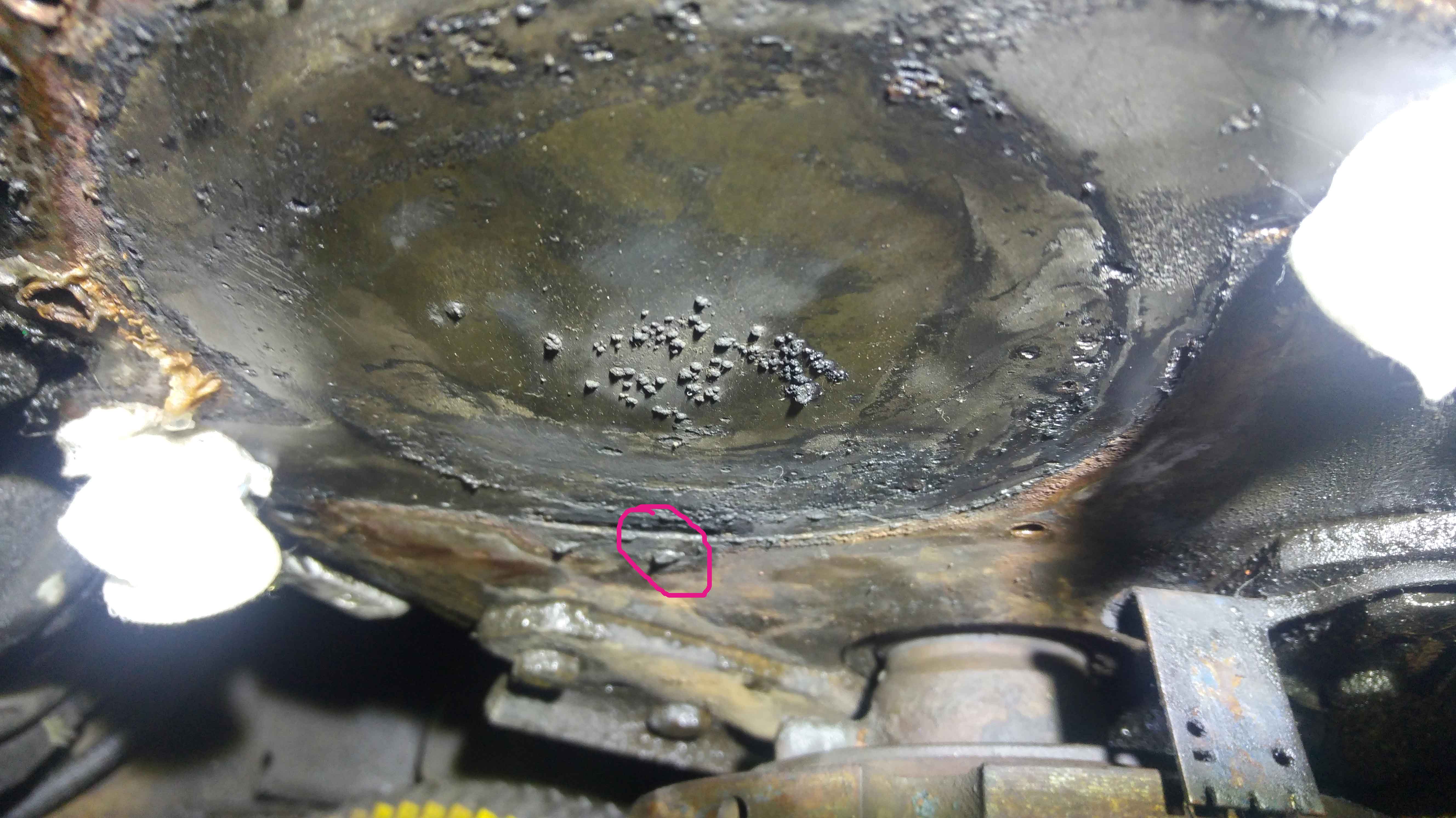

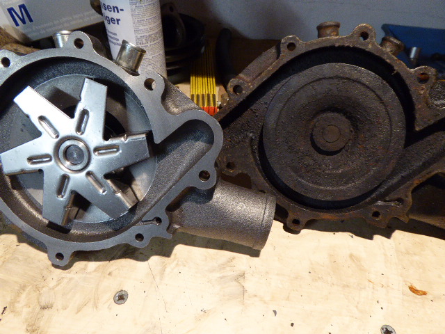

yesterday water pump get a lecage, one screw is broken... on the picture on "6 Hour" you can see that...
after 1 hour everything on my table, very funny technical solutions, and easy, i hope to get it back into the toronado
any idea for the brocken screw?
the another elemts of cooling system seems to be not new
but this is not bad
- thermostat
- j.jpg (495.69 KiB) Viewed 33692 times
- brocken screw
- c.jpg (529.72 KiB) Viewed 33692 times

Wow, that's a lot of sludge in the system.
When you finally get it put back together, don't fill it with anti-freeze/water at first. Flush the system as thoroughly as you can. Run the engine with the radiator drain cock open while you're adding water from a hose to the top of the radiator. After you get as much out as you can (when the water runs clear out of the drain cock, you may want to then flush the system with one of the chemical kits from an auto parts store like Prestone.
Then when that's finished, fill it with your water/anti-freeze mix.
As for the broken screw, is there enough to clamp a vise grip pliers to it? If so it should be easy to unscrew. If not, you'll have to drill it out with a drill or Dremel tool. If you can do it without damaging the threads, great. If not, you'll need to run a tap into the hole when you're done.

waiting for the new water pump.....
Re: Hello from Germany!

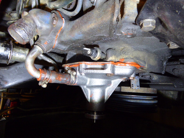

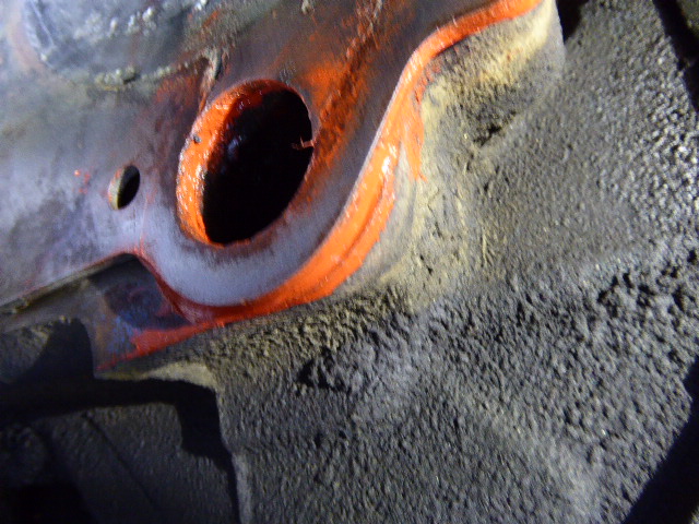

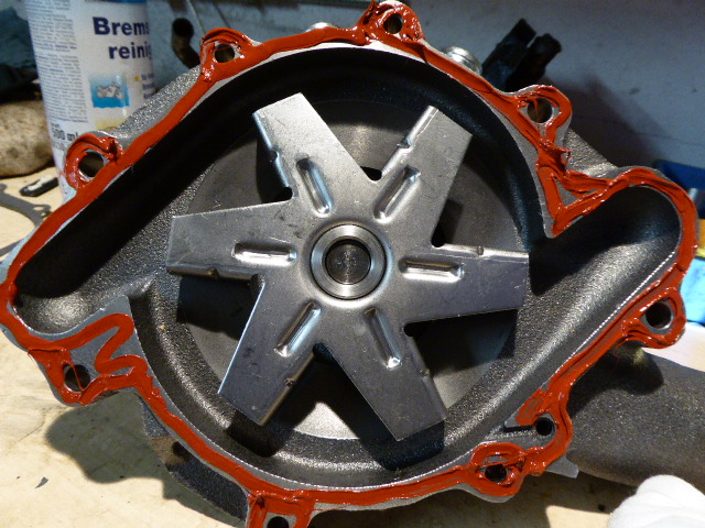

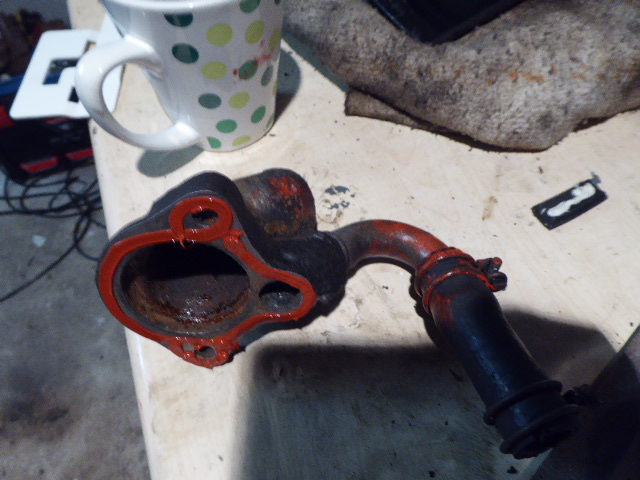

today i got and put in a new water pump...easy going.... some pictures from the job ..... now i wait 1-2 day and prepare the cooling system again and hope .....

I replaced my pump a year or so ago and noticed the different design of the new pump.
At first I was a little worried but my Toro runs so much cooler now with the new pump I'm quite surprised and happy. It never overheated with the old one but the needle would generally stay pointed straight up in the middle of the gauge.
Now it barely gets off the first E in the word TEMPERATURE.
