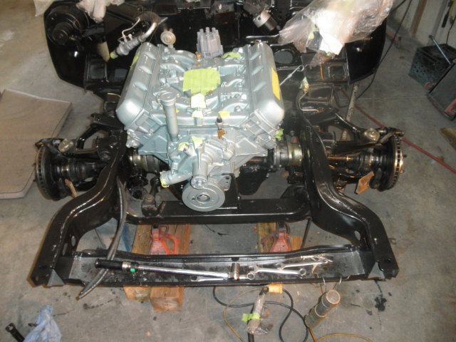

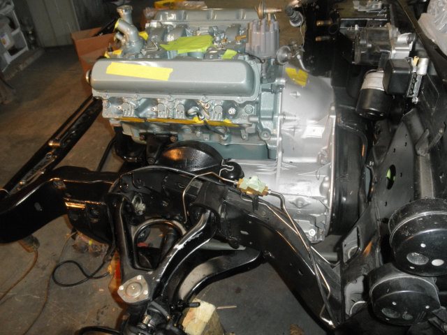

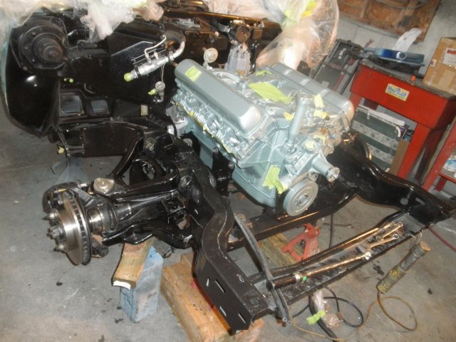

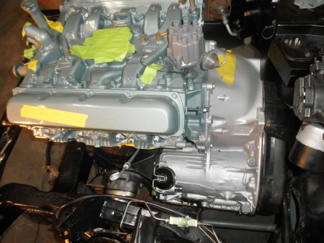

Here are a few photos of the progress. I haven’t worked on it to much this winter. It’s been too darn cold! Hopefully I will get myself motivated to get back out there soon.
Funny how the greeny-blue looks very light in this pictures. I am going to install a 67 dual snorkel air breather instead of the stock 68. I have made a few alterations to accommodate the switch over. I used valve covers from a 67 425 instead of my 68 455 covers. I also had to slightly modify the 67 breather by cutting out an piece from a spare 68 breather I had and welding in place on the 67 breather. Basically it’s an indentation on the bottom of the breather. The 68 has three indentations on the bottom while the 67 only had two. The third indentation on the lower right helps clear the brackets for the AC compressor.
As you can see I also disc the disc brake conversion.
In deep with my 68

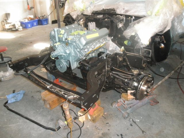

Re: In deep with my 68
A couple more

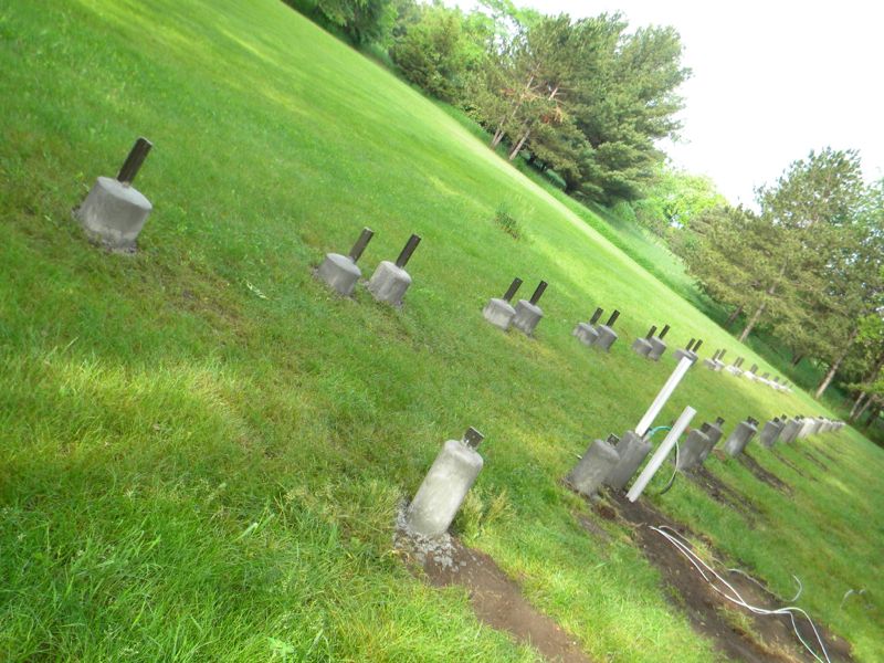

Project of the month is an 18,000 watt grid tied solar array, 11' high by
126' high. Foundation done, this pic very early in a sun day. 72 panels
waiting. Bruce Roe
