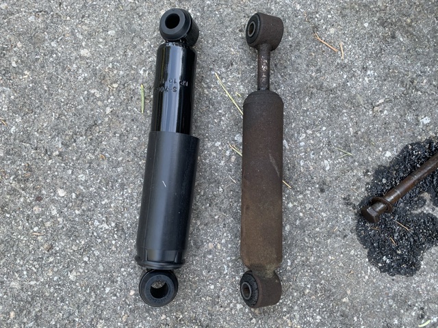

Update: Probably gonna have to buy from a different brand, apparently Gabriel discontinued the 82139 and no longer sells them.
There is a couple other brands if you want something cheap and temporary:
Victoria British shocks for 62-80 Triumph Spitfire (okay quality but won’t last as long as KYB)
Part #: 5-435
Price (as of 2020): $19.95
British Parts Northwest shocks for 62-80 Triumph Spitfire (Unknown Quality)
Part #: GDA4011
Rear Horizontal Shocks (1st Gen Toronado)
Re: Rear Horizontal Shocks (1st Gen Toronado)
Yes, Summit shows the shock as being for a Triumph Spitfire but is out of stock.
Here's a Gabriel on Amazon for $11 https://www.amazon.com/Gabriel-82139-He ... B001AM8GEY
Here's some on ebay for $18 and free shipping
https://www.ebay.com/p/75430427?iid=154 ... 0854.m4779
Extended Length in Inches 12.98
Collapsed Length in Inches 9.97
Stroke 3.01
Stroke 3.01

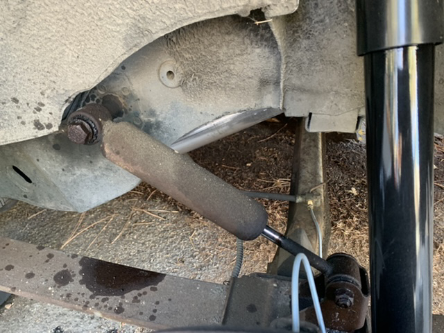

I was finally able to replace the horizontal shocks today (snow thawed) and wow! The car feels fantastic and I don’t feel the turns! Feels like a modern car!
