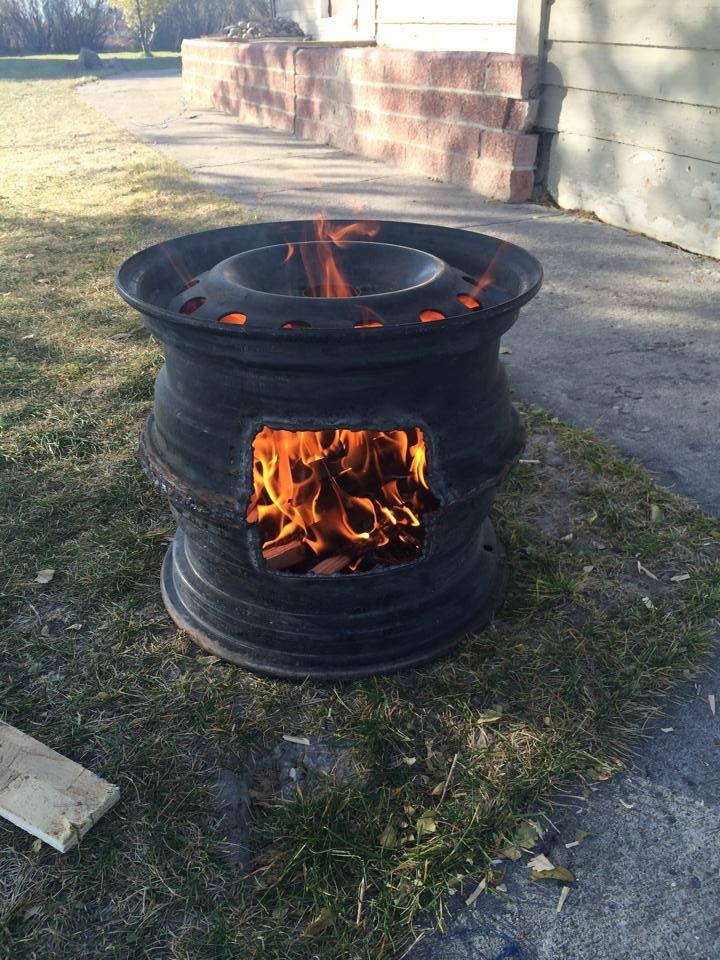

Hello all,
I was looking at some sort of "do it yourself " website at ideas for rocket stoves and saw this one.
Looks a lot like Toronado wheels to me. Wonder how many are going to that final use?

Yup, those sure do look like Toronado wheels. What a sad state of things.

Considering that those would have likely been scrapped otherwise, I think it's a cool use for them.

Those wheels are HOT!!! (Sorry, couldn't resist.)

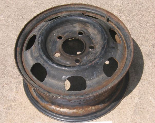

Just wanted to ease your worried minds...
The Frankilin stove in the first post is not made from Toronado wheels.
The Toro wheels came in two styles. One has 7 large holes and the other has 10 smaller (but still large) holes.

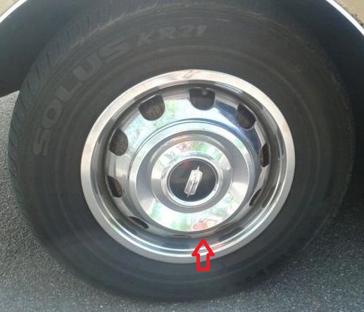

Re: Toronado Wheels ? And....
hey otto,
why are there two different styles? IIRC its about disc and drum break right?
on my 1970 toronado with front disc and rear drum brakes i have set of those 10-hole-wheels on it...but its always a PITA to mount the 1970 full-cover hubcaps and theres a really big gap between the hubcap and the tire. maybe thats because the 10-hole-wheels were made for center-caps only?
Yes. In '67 the depth was changed to accommodate disc brakes, however the '66 takes a wider trim ring.
The '66 is deeper where the chrome meets the steel. The '67 is shallower. (see red arrows on pics) The '66 wheel is the second photo below.
The 7 holer above is from the 70s
'67 wheels will retrofit to '66 but not vice versa. Of course you also have to match trim rings to the proper year rim
The valve stem location is also different on the 7 holers and 10 holers which may cause problems mounting caps and rings.

all right..thank you
looks like i have to get a set of correct wheels to make those hubcaps fit properly. at least those wheels also came with the eldorados right?
