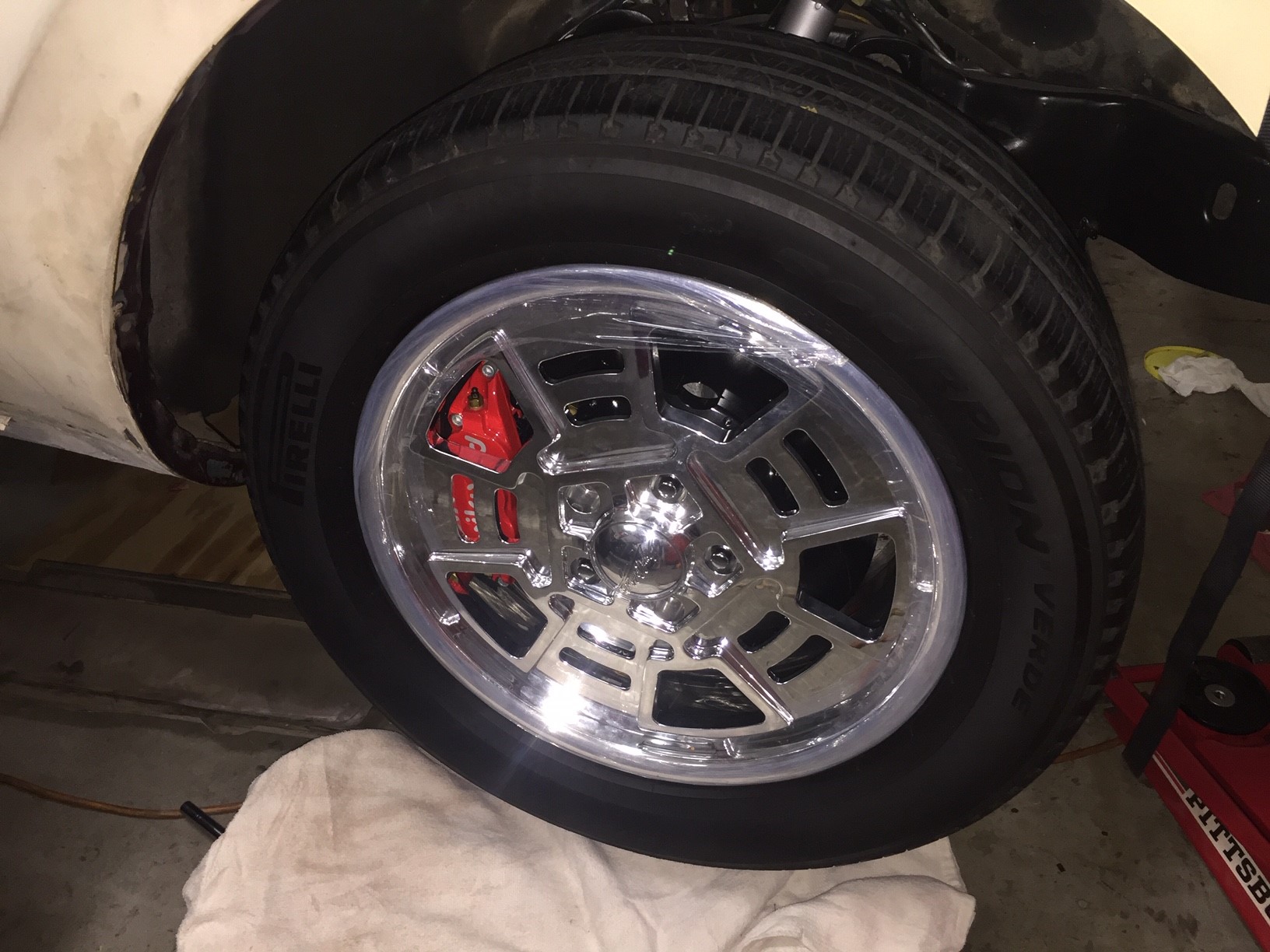

The tank I found is from a 1970- Olds 98, 26 1/2 gallon, and I had the trans rebuilt and also have the switch pitch module. The wheels are by Boyd Coddington.

Here is the completed Wilwood brake assembly, 14" rotors and 6 piston calipers, rebuilt steering box with a quicker ratio, all new urethane bushings, upgraded ball joints ,tie rods , sway bar end links, shocks. We also installed a rear sway bar and are working on rear suspension brake upgrades.
